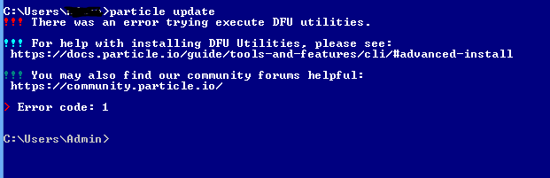

@Brus, if you have Particle CLI installed (if not, then please install it) then with the device in DFU mode try:
- particle udpate
- particle flash --usb tinker
@peekay123, Getting following error
device manager shows
@Brus, did you install the Zadig driver required for DFU to work?
@peekay123, Thanks I have successfully connected Photon to particle cloud. Wonderful, at last it is breathing cyan!! :grinning:
