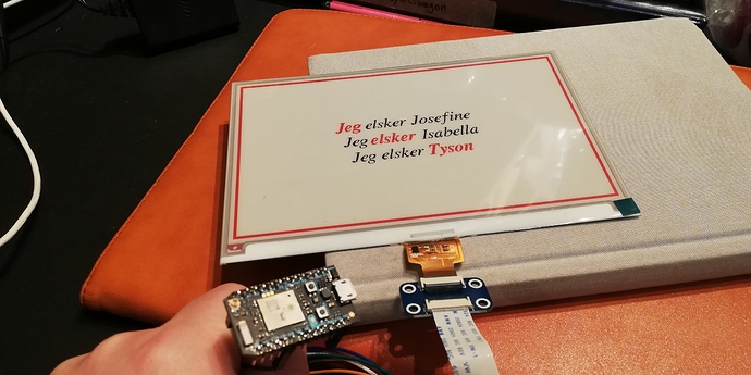

I have been playing around with the fantastic lib GxEPD2_PP build by @ZinggJM :hugs:
Want to build a display that shows some citations. I had it working at some point and it looked like this:
But then I messed it all up..
Don't know what I did wrong.. But I have now moved it all out of web IDE and using the vscode particle workbench instead - so I can use git and be able to revert back (next time I mess up).
I would be very thankful if anybody can point out to me what I'm doing wrong.
I haven't refactored the code to be clean, yet - but it looks like this now:

Hi @Norfeldt
I read through your code and it doesn’t look like you ever use the returned value t2bh or anything else to increment the y value for the cursor position, say at the of one of the while loops. That didn’t seem correct to me if you wanted your display to have three lines of text.
thank you @bko for taking the time to look at my code. I appreciate it.
When I do particle serial monitor I get the following
Starting eCitations
nLines: 3
sentence: **Jeg** elsker Josefine
citation: Jeg elsker** Isabella;Jeg elsker **Tyson**
x: 263
y: 239
sentence: Jeg elsker** Isabella
citation: Jeg elsker **Tyson**
x: 197
y: 239

@bko You pointed me in the correct direction! It’s because I keep changning citation in the while loop.
This prints all 3 lines (but still needs some fiddling).

Here is the working version (still needs refatoring)
