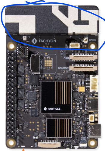

Where do you see pogo pins? There are some underneath the cellular and Wi-Fi antenna module if you've looking at a disassembled picture.

Oh, so the section of the board highlighted in the picture is the Cellular/Wi-Fi antenna?! Very cool
