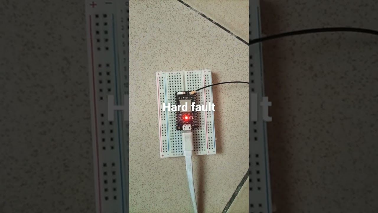

As regards the SOS, I tried uploading a video but there is a restriction on the community platform. The short video showing the pattern is here:
A single red flash after the SOS pattern is a hard fault, a few different things can cause this, id check the docs here:Status LED and Device Modes - Photon | Troubleshooting | Particle
