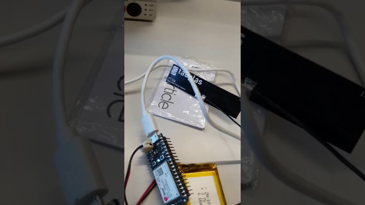

Can you post a hi-res picture and possibly a video of the setup and blink pattern (from reset till ~30sec after)?
I recorded a video but idk why I cannot upload it here, seems it’s only pictures are allowed.
You cannot directly upload to this forum but can post a link to a video service like YouTube.
On your photo the RGB LED looks cyan to me.

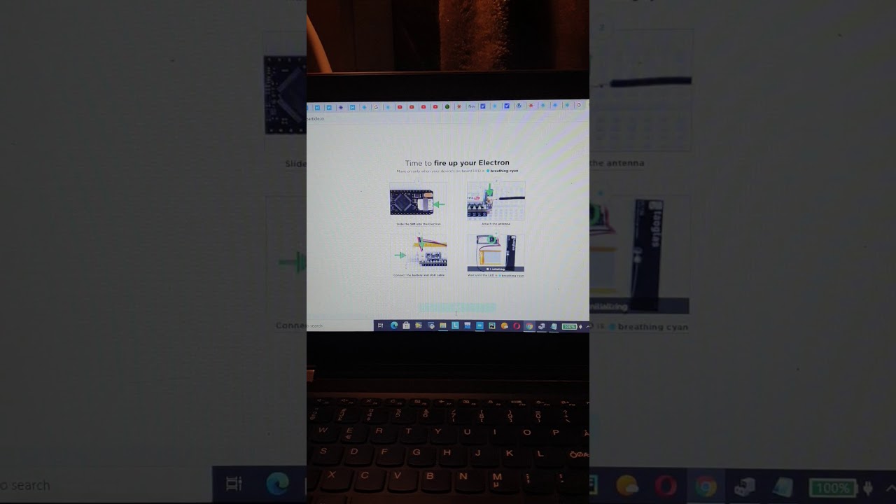

Here#s the link on Youtube for setting up the Electron.
If you are able to detect or know what’s the problem inform me, please.
another video
These videos don’t show enough of the interesting parts - what does the RGB LED do while the setup is ongoing.
However, it seems the Electron is breathing cyan and hence you should be able to claim it some other way.

Check the Video here :
