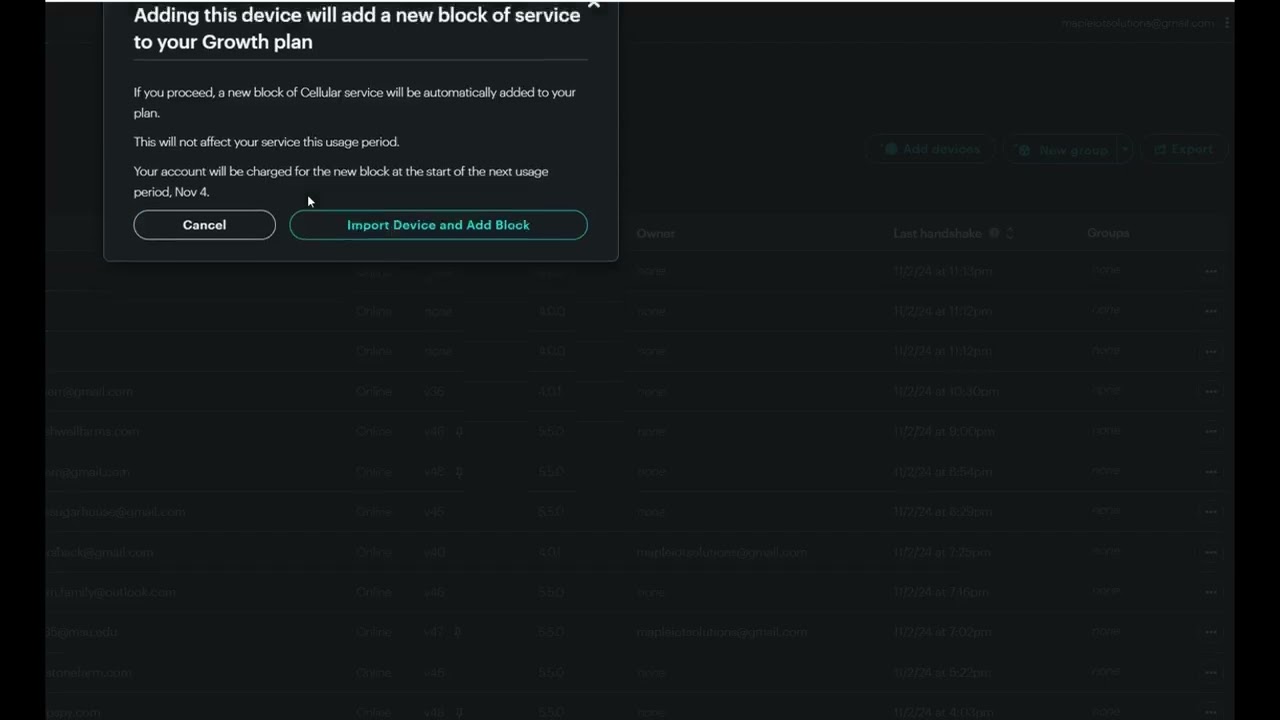

Looks like the Particle Console has some sort of bug where I am unable to add devices manually. I think what is happening is it's blowing by the prompt "adding this device will add a new block of service to your Growth plan". The popup appears momentarily (maybe 500 ms tops) and the new device is never added. I suspect it's only an issue for either those on growth accounts and add a device count limit or maybe any limit where a new block is added.
Here's a short video of it. You have to play it really slow to catch the momentary popup and if I search for that serial number it doesn't appear in the list. It seems like it was cancelled automatically.

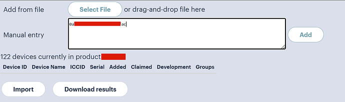

Okay, this is odd... the DeviceID shown in the import list is different from the one I'm trying to add. This part is using Google Chrome. Before hitting the "add" button:
And after:
The DeviceID listed in "after", 0a...d4, is already in my product, and different from 0a...ac which is not. This appears to happen when the Device has been removed from the product. If the device is already in the product it shows up in the list correctly.
Could you DM me the actual device ID that you are trying to add? The box accepts Device ID, ICCID, or Serial Number and it may be detecting it as the wrong thing.
Fixed a bug in the Import devices tool where it would not import Wi-Fi devices that do not have an ICCID.
