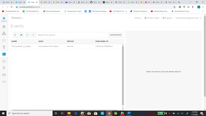

  • what do you see in console?

The LED remains breathing cyan when flashing fails.
Safe mode tells us it is healthy.
We just ran the flash in safe mode and it was successful. What does that mean?
When we just did the successful flash in safe mode the LED went back to breathing cyan
