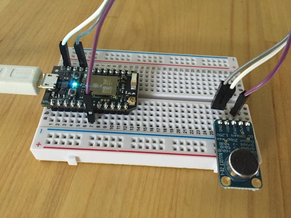

hi there. I am trying to do a project from D Middlecamp but having a hard time… Maybe someone can guide me through the steps, because the explanation on Hackster.io is not clear to me (I am a beginner).

1 Downloaded the two files of the project to ~/…/soundproject
2 Modified the files by changing the ipAddress in waveRecorder.js:
// Put your IP here!
var settings = {
	ip: "192.168.0.54",
	port: 3443
and in main.ino
// so we know where to connect, try:
// particle get MY_DEVICE_NAME ipAddress
Spark.variable("192.168.0.54", myIpAddress, STRING);
IPAddress myIp = WiFi.localIP();
sprintf(myIpAddress, "%d.%d.%d.%d", myIp[0], myIp[1], myIp[2], myIp[3]);
3 Uploaded the files to my Photon using the CLI (“particle flash abc23434absbs soundproject”)
and then I’m lost. Is it working? I have no idea? Where does test.wav get stored?
I hope someone can help me.
Thieme
Your link is broken.
Actually only the main.ino should be flashed to the Photon.
The waveRecorder.js you'd run on your computer and there will the wav file be stored too.
aha! The next thing I was wondering was how to run a js file in terminal, but I found out! With Node.js you just type
node waveRecorder.js
(assuming you are in the correct directory). And it works!! (I haven’t tried yet with the Photon turned on, it’s in another room and I’m in a rush). Thanks a lot!
PS. I thought it would be a stupid question, but apparently many people have the same question:
it worked!
