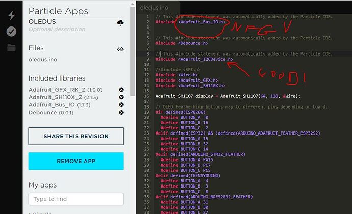

ok here’s what I got .
is compiling fine for Argon under OS4.0.1 without any compiler errors but I couldn’t test it as I don’t have this OLED
what I found it that Adafruit_Bus_IO did not include automatically and even if you include it
manually it’s still no good as it’s trying to include Adafruit_Bus_IO.h which even doesn’t exist in Adafruit_Bus_IO
instead you have to #include <Adafruit_I2CDevice.h>
Not sure about a #include <Debounce.h> as is compiling fine when I mark it out but just in case I leave it in the project.
I used the example OLED_featherwing.ino from ADAFRUIT_SH110X_Z so you can gave it a try :+1:

Actually, I don’t need it just want to help a little @kreys001
The one on top on my previous post compiling just fine on WebIde for Argon Boron and even for photon with os 2.0.1. I couldn’t try it as I don’t have an OLED.
