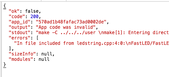

Not the cache. I’m using Chrome on OSX. When it doesn’t work, the compiler returns HTTP status 422. In the UI, the half-window comes up from the bottom but it’s blank. I’ve gotten pretty good at commenting out blocks of code until it compiles and using that to find the problematic line, but it takes a long time.

Okay, I’m getting the 422 error again. Now that I’m inspecting it I see the 422, and it looks like the body says it is returning a 200- so perhaps the http reverse proxy is messing it up.
and here’s what the UI looks like.

Aha- I can reproduce that now. I didn’t figure out that it was associated with the search bar, but I can perfectly reproduce it now. Even in the “success” case 422 is returned, so that’s a red herring. The root of it is the search bar being there, even if it’s empty.
So, heh, it’s a JS issue, not a devops issue
