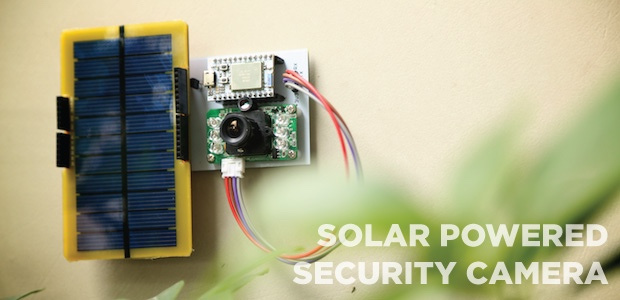

Got it working, ported the newer library, yay! Demos to follow. :slight_smile:
Posted a basic intro project here:
Enjoy! :slight_smile:
Thanks,
David
Ohh people have been asking for this since the Spark Core Kickstarter campaign :slight_smile:
omg blast from the past. I definitely need to build this now.
