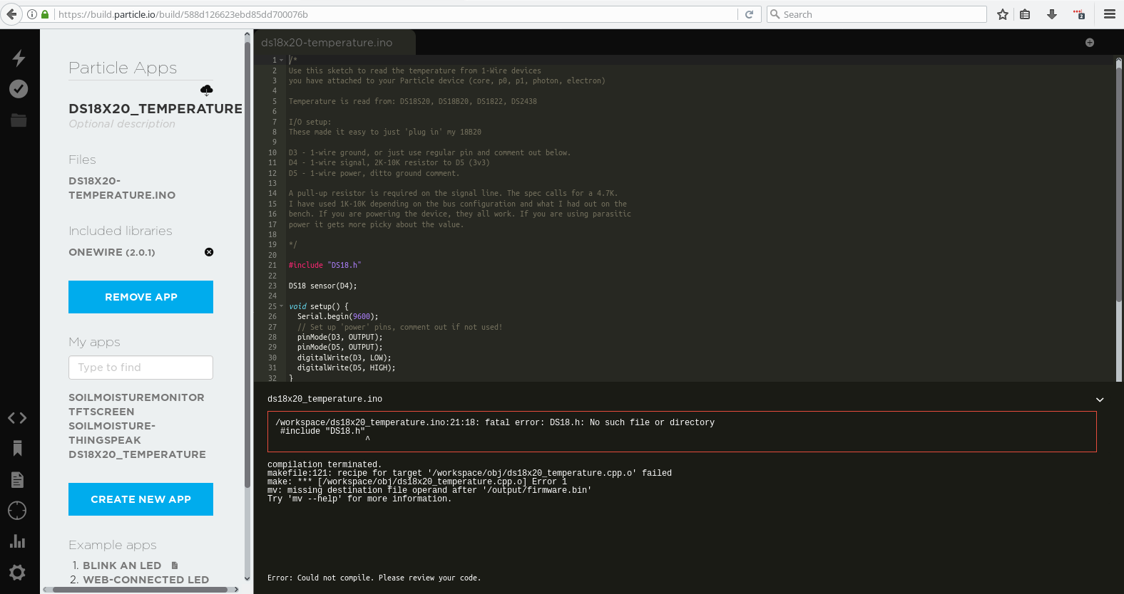

resultant error below, code is unchanged from the example:
Checking library ā€˜OneWire’…
Installing library ā€˜OneWire 2.0.1’ to ā€˜/workspace’ …
Library ā€˜OneWire 2.0.1’ installed.
DS18x20_Temperature.ino
/workspace/lib/OneWire/examples/DS18x20_Temperature/DS18x20_Temperature.ino:21:18: fatal error: DS18.h: No such file or directory
#include ā€œDS18.hā€

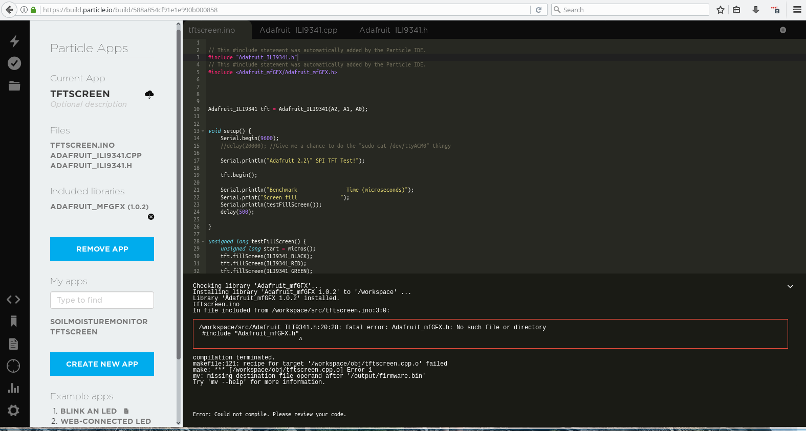

Checking library ā€˜Adafruit_mfGFX’…
Installing library ā€˜Adafruit_mfGFX 1.0.2’ to ā€˜/workspace’ …
Library ā€˜Adafruit_mfGFX 1.0.2’ installed.
tftscreen.ino
In file included from /workspace/src/tftscreen.ino:2:0:
/workspace/src/Adafruit_ILI9341.h:19:43: fatal error: Adafruit_mfGFX/Adafruit_mfGFX.h: No such file or directory
#include ā€œAdafruit_mfGFX/Adafruit_mfGFX.hā€
tftscreen.ino
/workspace/src/tftscreen.ino:2:28: fatal error: Adafruit_mfGFX.h: No such file or directory
#include <Adafruit_mfGFX.h>

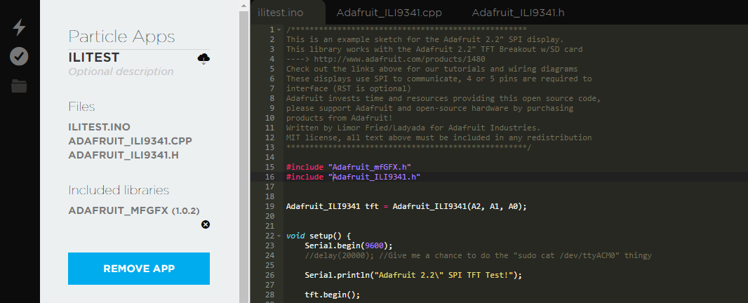

Now I have done the same thing and got it to build.
There are only two lines in the header file that need to be replaced
#define pinLO(_pin)	(PIN_MAP[_pin].gpio_peripheral->BRR = PIN_MAP[_pin].gpio_pin)
#define pinHI(_pin)	(PIN_MAP[_pin].gpio_peripheral->BSRR = PIN_MAP[_pin].gpio_pin)
should now be
#define pinLO(_pin)	pinResetFast(_pin)
#define pinHI(_pin)	pinSetFast(_pin)
And this is how your project should look (ilitest.ino or testgfx.ino or tftscreen.ino doesn’t matter)
BTW: With a correct setup your includes in Adafruit_ILI9341.h can be any of the three ways I’ve suggest, just not how it’s in the lib originally
#include "Adafruit_mfGFX/Adafruit_mfGFX.h"     // works
#include "Adafruit_mfGFX.h"                    // works
#include <Adafruit_mfGFX.h>                    // works
#include "../Adafruit_mfGFX/Adafruit_mfGFX.h"  // does not work anymore
so I get this. same setup as far as I can tell, but I get the same error as before. I did fix the lines in the header file as well.
That’s odd in deed.
What system version are you targeting?
I was building for 0.6.1-rc.1
Maybe create a completely fresh project and copy/paste the sample .ino too.
That’s how I did it. It shouldn’t make a difference, but grabbing straws now :confused:

This is interesting, because I copied and pasted the example into a new program, then included the OneWire library, but the error mentions the other examples. This should not have anything to do with the examples. I’ve seen this a couple of times now. does not make sense to me.
Hi @justinmary
I am no longer sure what problem you are trying to describe or solve.
Yes, the Thingspeak library intentionally errors out if the platform ID is not one of the expected values. This is because there is some amount of platform specific code in the library.
For One Wire, you don’t seem to have included the DS18.h library in your project anywhere. There is not a way in the IDE that I know of for authors to say, ā€œthis example requires these two librariesā€ which I what I believe this problem to be.

https://community.particle.io/uploads/particle/original/2X/e/e18632e3f88e8ff4c105520e78b190e88fb6460a.png
note this example where I actually copied the DS18 library into my own program. it does make it work. but fails when it gets to application.h
