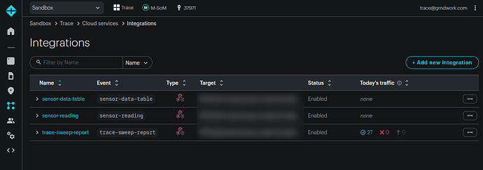

I have a webhook question. I created 3 webhooks from the console and they work fine when my msom publishes. However, I wanted to write some unit tests using 'particle publish' command and found that my webhooks are never called even though I see the published events with 'particle subscribe'.
The console shows that I have 3 webhooks configured. However when I query the webhook list from the command line, I get a different answer

It looks like the console is using a product webhook, which is what is recommended.
When you use the CLI, by default it uses the integrations in the top level of the sandbox, not a product within the sandbox. You've created two webhooks in your test, and it's possible that both could execute for a real device triggering the webhook.
To make the CLI work with a product webhook, add the --product <product_id> command line option.
