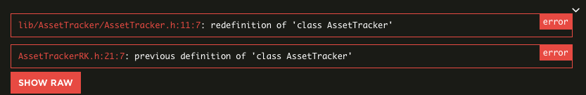

After spending too much time trying to use VS Code, I went back to Web IDE and moved the .h and .cpp files for AssetTracker_RK into their own tabs. So the .ino and all libraries (used via #include) were available. But when I compile I get a errors about redefinition of AssetTracker. It is not at all clear to me where library files are supposed to reside. In VS Code or in the Web IDE. I’ve read the tutorials, but they are not at all clear as to how all of this hangs together. I would have thought that by including all the requisite libraries in my application (via the tabs), things should have at least compiled cleanly.
If you are copy/pasting the library files into your own project you mustnot also import the same library into your project.

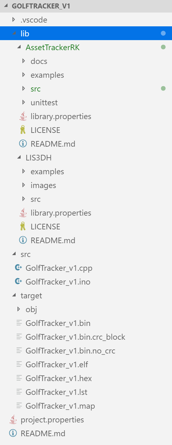

This is how my correctly setup project looks and builds (click image to see the whole)
Steps to reproduce:
and follow instructions -
AssetTrackerRK - copy own source code to
./src/GolfTracker_v1.ino
