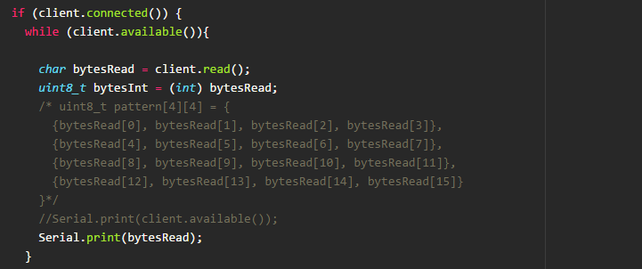

Hi so I’ve looking over this documentation and there really is not much here. What is the best way to use client.read() if I am trying to have a client send my particle a list of integers and then have the particle store the list of integers within a variable?
Eventually I want to get these integers sent into some sort of array.

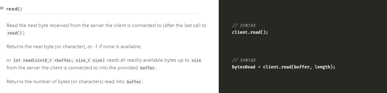

There is a lot more a bit further up in the docs about TCPClient tho'
https://docs.particle.io/reference/firmware/photon/#tcpclient
But if you want to send and receive an array of integers you first need to understand how integers are stored in memory and how they get packed into an array.
Then you can use the second overload of TCPClient::read() which takes two parameters and is documented too.
It's all there when you know the basics and how to apply them.
The documentation of one function can't always reiterate all the basics and all possible use-cases. Things need to be presumed to be clear in order to build ontop of.
