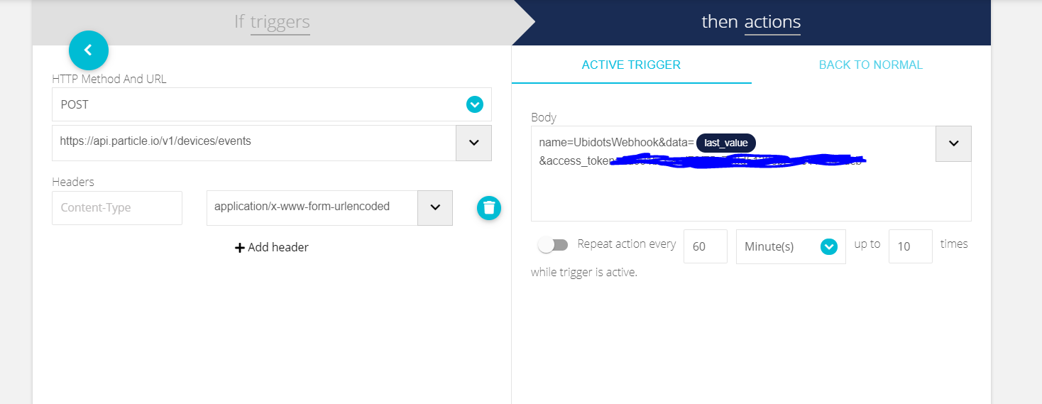

It seems your outgoing (from device to the webhook manager) event is not valid.
Your screenshot above only shows how you instructed Ubidots to send data to Particle.
Your data is shown but it’s not valid JSON.
A valid JSON would look like this
{ "value": 1.0 }
(of course "value" should be the key that you’ve used on the Ubidots side to store the data in)

I thought that with the ubidots webhook i was sending data to particle cloud. and from there i would grab it with a subscription to my device. So to check if the first step works, i was just sending the data from ubidots to particle without any device in use.
