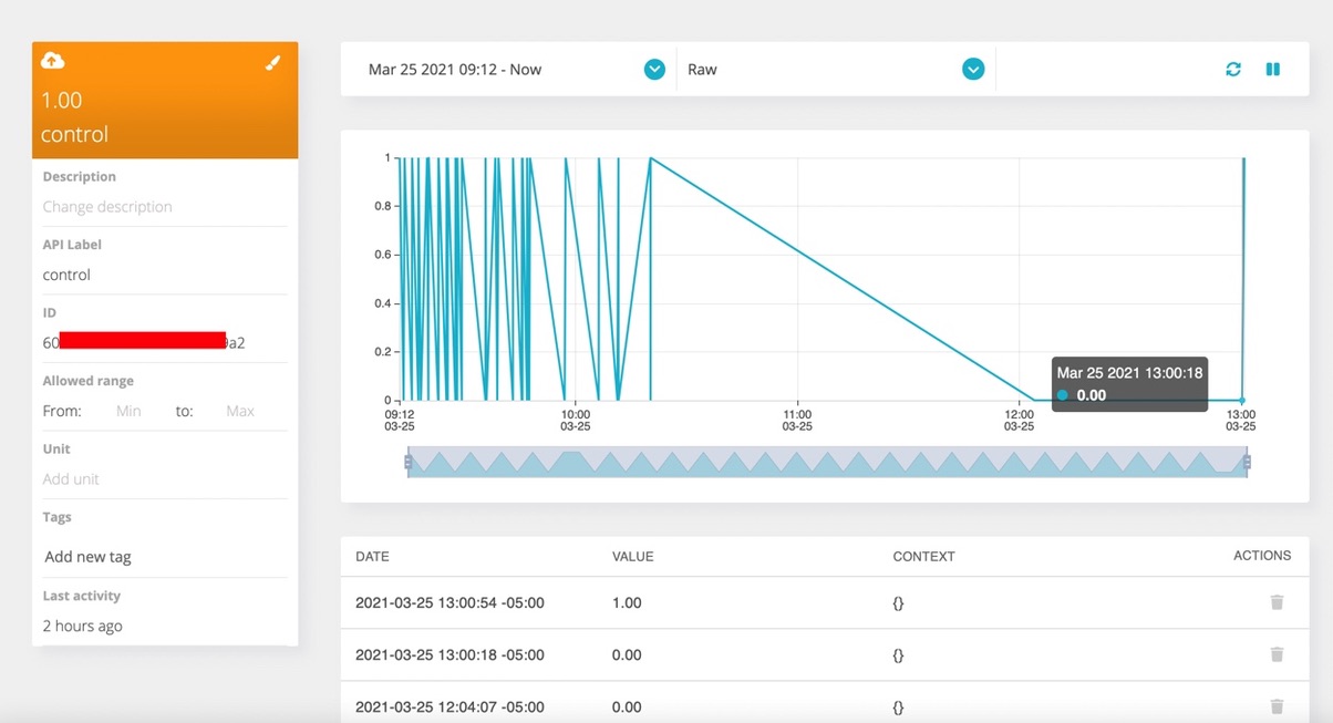

Yeah, I replaced the Particle_Token text with a Two-Legged Auth (Server) token in both the “Active Trigger” & “Back To Normal” body fields.
Here is the Ubidot Event Config:
When I toggle the switch, it produces points on Ubidots event view:
