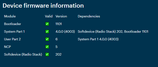

Hi Rickkas, unfortunately I can’t seem to get the Doctor tool to use Ethernet, despite selecting it in the advanced options - there is no apparent means to not use Wifi here? I end up with a slew of -230 / DNS errors.

Ok, one of the devices is now connecting properly. In the process, I have in addition to all of the fun stuff before(via the webtools and command-line both) tried resetting to Tinker on the latest device OS, then back to LTS 4.0.0 - no change - same thing with trying to use keys doctor.
Connection was successful after performing the following:
particle usb dfu
particle keys new
particle keys load device.der
particle keys send -v --product_id <prjID> <deviceID>  device.pub.pem
Then reset the device.
