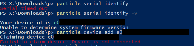

The issue that remains is I am unable to claim the device in CLI or the mobile app
With clean firmware upgrades, the ‘cant move past “do you want to use mesh”’ issues remains
in listening mode (blue flashing)
PS X:\Downloads\p> particle identify -v
Serial timed out
VError: Serial timed out
at whatSerialPortDidYouMean.then.then.catch.err (C:\Users\Dan\AppData\Local\particle\node_modules\particle-cli\dist\cmd\serial.js:321:13)
at <anonymous>
at process._tickCallback (internal/process/next_tick.js:189:7)
Looks like it doesn’t know what COM port to connect to?
My boron is on COM26
PS X:\Downloads\p> particle identify --port COM26 -v
Serial timed out
at <anonymous>
This is all in listening mode, should I be in a different mode for this?
