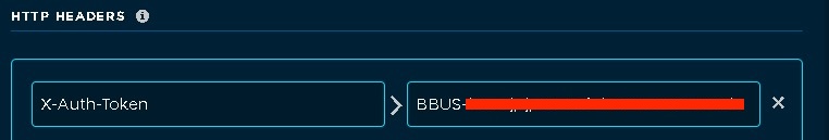

HI @friedl_1977,
Yes, I've done the same. Just to be sure, the token is the one in the API credential section, right?
Here is a screenshot of what I have setup :
Best regards,
Nayel
