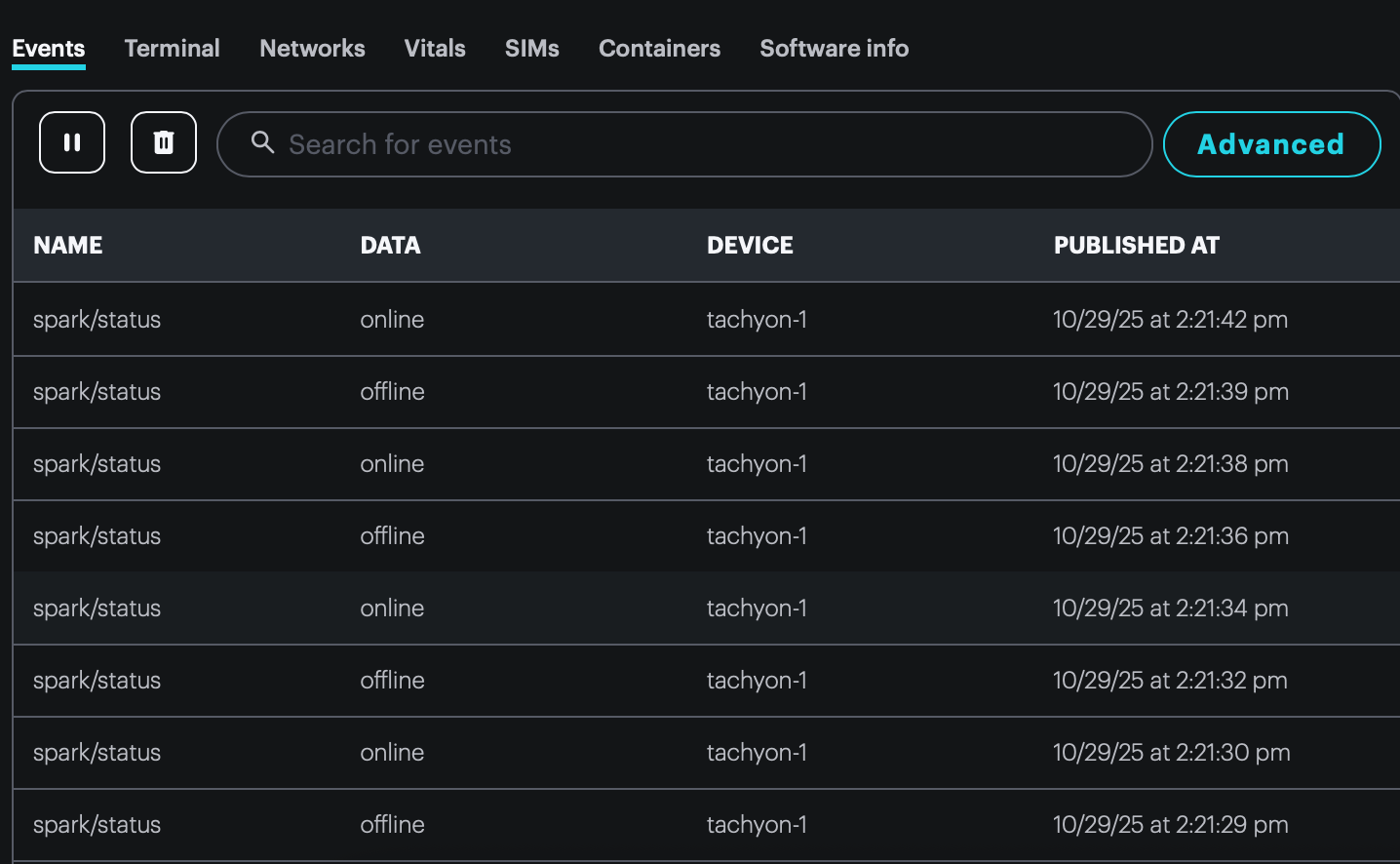

Since last week, I’m seeing a weird issue with Tachyon (Ubuntu 20.04) repeatedly alternating between online (cyan) and offline (green) states. I haven’t seen this behaviour before at all. Up until a week ago, the cellular connection was rock solid and LED indiction was correct with ‘breathing cyan’.
I’m able to SSH via WiFi. However, Particle Console reports that the cellular connection drops repeatedly after a few seconds. I’m not able to open a shell session from within the Console.

However, the Tachyon LED alternates between Cyan and Green every few seconds. I’m not able to open a terminal session via the Particle Console.

I’m able to connect to the Tachyon remotely via Tor. So, the cellular connection is working. I suspect that the Particle Console is reflecting the repeated cyan/green LED states and indicating cellular connection/disconnection.
I’d appreciate if someone from Dev can look at the Console & LED issues. I’ll be glad to assist with any additional troubleshooting.
