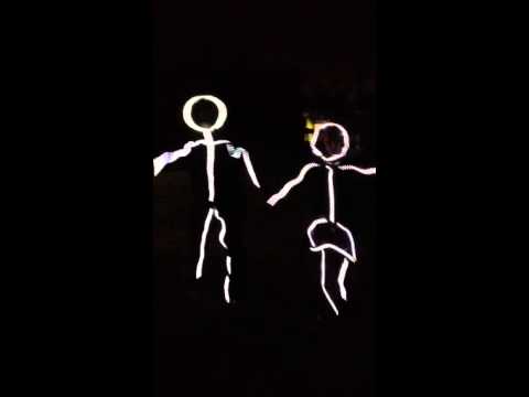

So my second spark project (I wish i got more than one core as a beta tester!)
I decided to create a ripoff of this awesome costume (http://youtu.be/GkBDRUO8hAo)
But with a little spark magic! I hooked up the LEDs to a relay board, and then connected the spark to the board. We carried 12v batteries in a bag hooked to our belts.
So here is the basic video:
http://youtu.be/Nb61sPq-2sE
When anyone texted the word “Where is the devil?” to a phone number, my eye turned red and the pitch fork and/or eyes lit up. (i was carrying a 4g hotspot)
I was also able to control the full suit from a series of SMS code words. If i sent “White off” or “White on” the LED would turn on or off. Same went for the red. I absolutely could have done that all with hard buttons, but using code and a cell phone is so much more fun!
This was all done with a bit of twilio magic, and this hacked together PHP script
