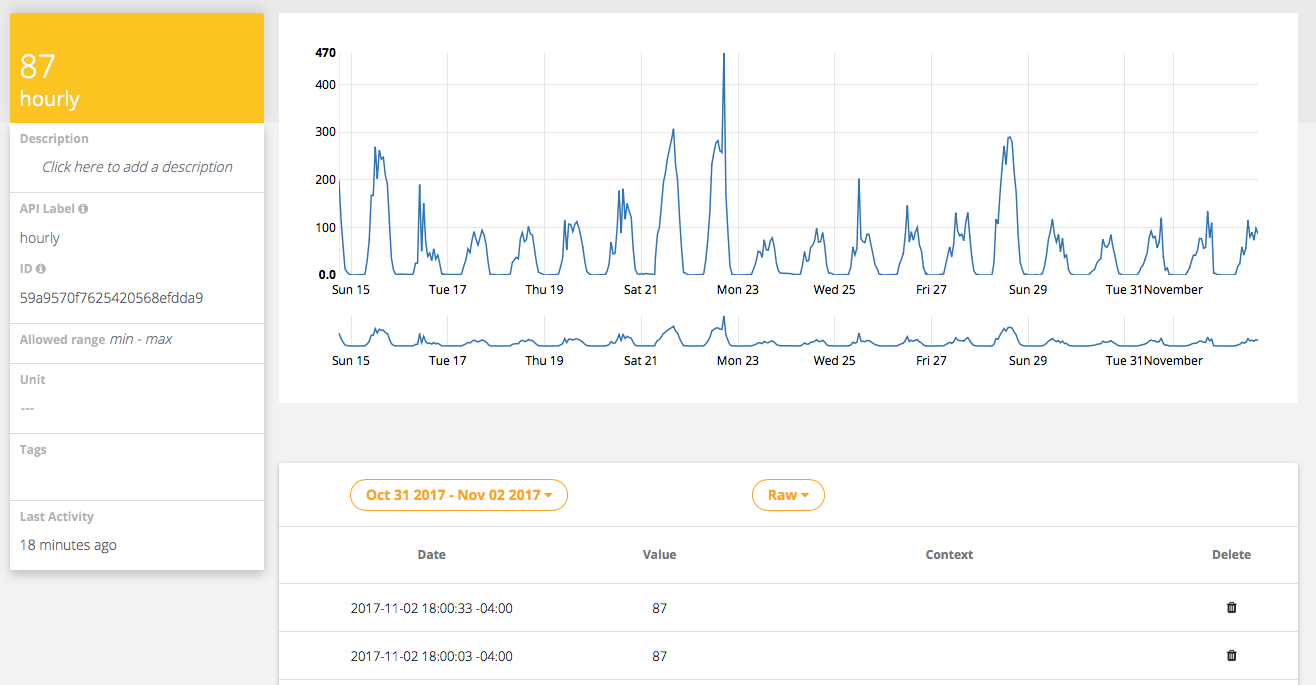

So, here is my question. If I am not getting ESOCKETTIMEDOUT from a slow response, could it be from multiple Electrons using the same Webhook at the same time? Is there a limit here which might require me to either create more web hooks or stagger the top-of-the-hour reporting?
Why this matters: When the web hook is sent, and there is an ESOCKETTTIMEDOUT, it is resent. Ubidots had received the first and second hooks and creates two data entries as you can see below. I would like to eliminate this duplicative data.
I am providing the screen shots from the activity log and the console output if there is more to the story in the data. Please let me know if you need to see more.

All,
In talking with the good folks at Ubidots and sharing this data, this issue has been resolved. Ubidots made some changes to how quickly they respond and I moved to their industrial service. These changes have made a dramatic improvement where I am seeing few or - as the attached imaged shows - no timeouts.
I guess the lessons here are:
  • Make sure you respect Particle’s publish rate limits (1 per second on average and no more than 4 in a second burst)
  • Write your code to subscribe to a response but allow for retries if there is a ESOCKETTIMEDOUT error
  • Work with your service provided and provide them with the information needed to diagnose the issue.
Thank you to @aguspg for helping me work through this - it is this service that endears me to Ubidots.
