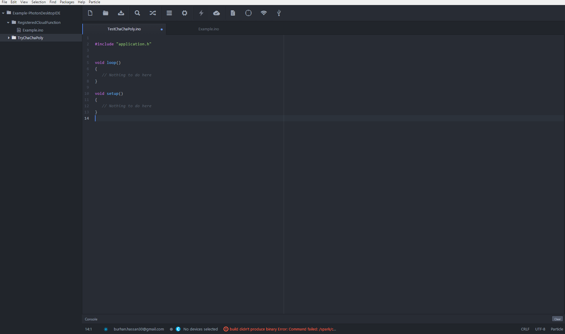

Hi , I am facing the same problem. I have updated the cli and tried to compile an empty project, but could not.have a look please, and see what else should i try.
This screenshot does not look like CLI it rather looks like Particle Dev :wink:
If you post a screenshot, could you provide one of the complete application window?
And maybe try selecting a device before you build, so that the IDE knows the target system.
Yes Exactly :smiley: from cli, it is compiling, but not with IDE.
here is the complete window:
What does your file directory look like? Is it ‘flat’? Does it contain other files than are necessary for your project?
The directory was D:\Example-PhotonDesktopIDE\TryChaChaPoly.ino and it had other .cpp and .h filea as well.
I tried with another example, in which,the directory is D:\Example-PhotonDesktopIDE\RegisteredCloudFunction\Example.ino
and it is the only file in the directory…but the issue persists…
A few points to check.
The screenshot you provided shows the cyan “dirty” spot to the right of the file tap, so there are changes that haven’t been saved (commited), but Particle Dev only builds what was saved.
I also see two open .INO tabs, in this case it’s not clear to Dev which one you want to build. Dev does not care what tab you’ve got open when you start build, since Dev is merely an Editor and not really an IDE. Building is rather triggered like an external command.
For above reason - it might be couterintuitive tho’ - it’s recommended to open the project folder rather than only a file from the folder, since the external command is aimed to build a complete folder content and not seperate files.
Finally, it helped. I removed all irrelevant Project folders and then compiled the .ino file, and is working.
