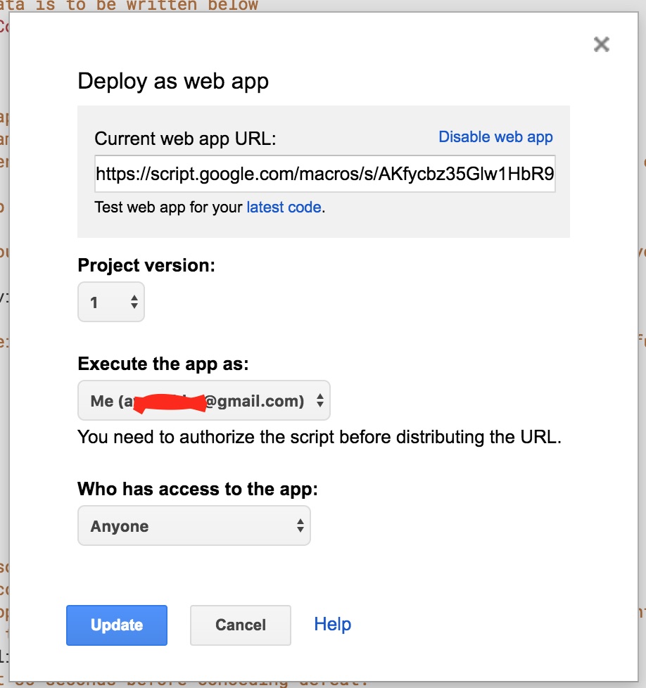

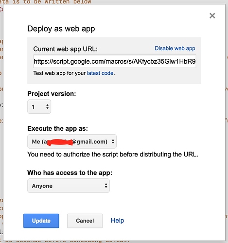

And yet the script is set for :

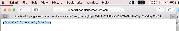

I DID copy/paste the URL from the script into a new browser (Safari) and ran it and got:
So it seems the script is working???

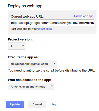

Hi, it could be.
However, have you tried setting the Who has access to the app: field to anyone, even anonymous, I see you only have it set to anyone:
OK… Thanks… Will try… However, I DID try EVERYTHING from the actual account user id where google-docs == particle-dev-userid… and everything seems to WORK.

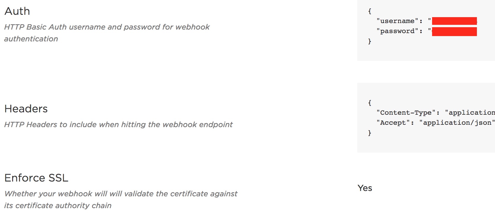

I noticed that @awardblvr has the Auth portion of the web hook filled in. Is this username and passwork the particle login or the Google account login? Is it supposed to be filled in? Mine is blank.
