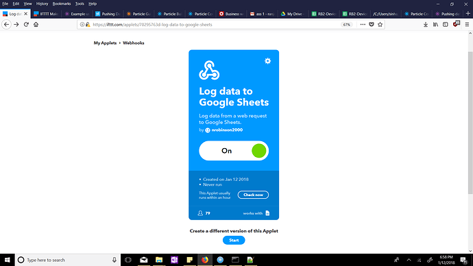

On the particle console I’m getting the following message:
“Congratulations! You’ve fired the to_google_sheets event”",“ttl”:60,“published_at”:“2018-01-12T21:37:24.080Z”,“coreid”:“particle-internal”,“name”:“hook-response/to_google_sheets/0”}
But nothing shows on the google sheet.

I’m really new to IOT. Would really appreciate some help.
And also this says, the applet was never run.

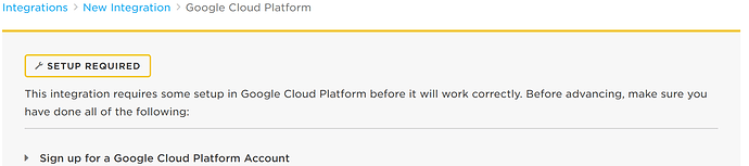

I would have liked to help, but Google prevents me from using a free test account since I’m located in Europe.
Does Google really do that to you? :cold_sweat:
I feel discriminated :see_no_evil:

What do you mean by this? I have never had to sign up for any test account, I use my plain google account...
Just curious
Gustavo.
And when I follow the provided links I end up at some FAQs that state this (translated from German as this is not displayed when viewing the page in English)
oh I think I get it now, your comment may apply to google docs via IFTTT, not to my tutorial on Hackster.
Am I right?
