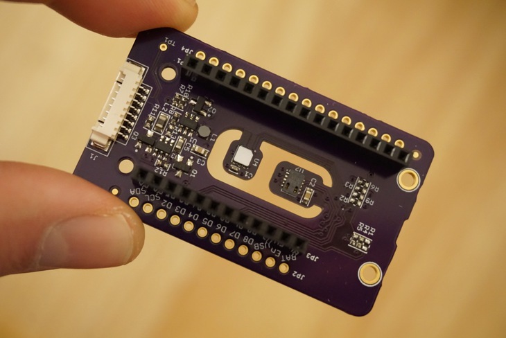

You might consider this device:
Not sure if it can be used outdoors in appropriate enclosure.
cc: @jaredwolff
Yea, I emailed them almost a year ago and they were not very forthcoming. I guess they're not interested in sharing their code. It's too bad because I'm sure a lot more people would adopt their part!
I don't have an outdoor enclosure designed for the board. I do have an indoor enclosure designed though. :slight_smile: I've seen implementations where the sensor is placed in a dome. The air is dawn in from an opening in the bottom. Example: Purpleair | Weather Underground
I discussed the used of the HPMA115S0 in outdoor environments with the Honeywell folks. At the time it was uncharted waters though they may have better insights now. (It's originally meant for monitoring air quality inside HVAC, etc)
