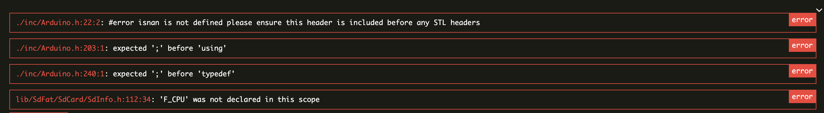

I am porting my main application over to Workbench. In doing the first local compile I am hitting some problems not seen with cloud compile on Web IDE that related to the SDFat library. I would appreciate any advice/help about how to understand and fix these 4 errors. The first 3 appear to be something to do with “Arduino.h” header which is included.
/Users/xxx/Documents/xxx/VSC_Projects/z-t-base/lib/SdFat/src/FatLib/FatLibConfig.h:139:0,
./inc/Arduino.h:22:2: error: #error isnan is not defined please ensure this header is included before any STL headers
/inc/Arduino.h:203:1: error: expected ';' before 'using'
using std::isinf
./inc/Arduino.h:240:1: error: expected ';' before 'typedef'
typedef USARTSerial HardwareSerial;

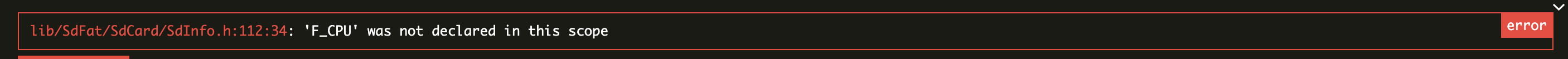

/Users/xxx/Documents/xyz/VSC_Projects/z-t-base/lib/SdFat/src/SdCard/SdInfo.h:112:34: error: 'F_CPU' was not declared in this scope
#define SPI_HALF_SPEED SD_SCK_HZ(F_CPU/4)
I have set the SDFat library version to be 0.0.7 whereas it appears to have installed 1.0.16 which is the latest and has these problems.

I had an idea to move the #include <SdFat.h> to just after #include “Particle.h” and low and behold the first 3 issues disappear. This last issue was solved before. I will go and try this on the Workbench copy.
Yes, F_CPU is not declared and that won’t go away as long you use any macro that expects it to be declared (i.e. SPI_HALF_SPEED).
The way around this is to either use SD_SCK_HZ(), SD_SCK_MHZ() or even better SPISettings() directly.
I am sure I can figure my way around that - thanks for the pointers.
