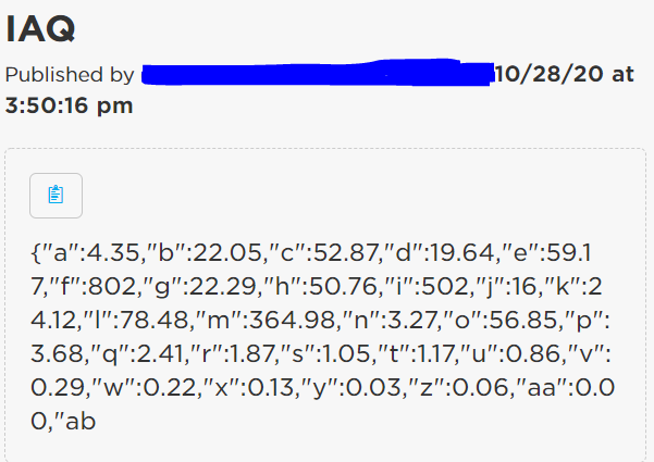

Here you see I receive exactly 265 characters:
{“a”:4.35,“b”:22.05,“c”:52.87,“d”:19.64,“e”:59.17,“f”:802,“g”:22.29,“h”:50.76,“i”:502,“j”:16,“k”:24.12,“l”:78.48,“m”:364.98,“n”:3.27,“o”:56.85,“p”:3.68,“q”:2.41,“r”:1.87,“s”:1.05,“t”:1.17,“u”:0.86,“v”:0.29,“w”:0.22,“x”:0.13,“y”:0.03,“z”:0.06,“aa”:0.00,"ab
I’m using a JSON writer as follows:
JsonWriterStatic<256> writer;
writer.setFloatPlaces(2);
JsonWriterAutoObject obj(&writer);
writer.insertKeyValue("a",value_1);
writer.insertKeyValue("ac",value_x);
writer.finishObjectOrArray();
Particle.publish("IAQ", writer.getBuffer(), PRIVATE);
Where values 0 to x would be readings from my sensors.
That’s sooo dumb… I see already. My json writer is only 256 long
