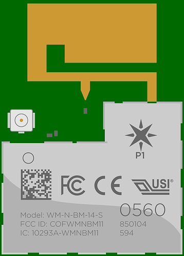

I have a P1 to evaluate and what interested me most was the 1 MB of extra memory. From what I understand the extra memory is the only difference between the P0 and the P1 boards.
I just figured the P1 would work just like the Photon when it came to programming over the web except with the P1 I would just see a larger memory bank when looking at the bottom of the online IDE after successfully compiling my code.
Seeing the metal can on top of the P1 had me just figuring the extra memory was built to the actual chip but now I’m thinking that under that metal can there is a separate 1 MB flash memory chip just like there is on the old Core’s . Is that the case?
