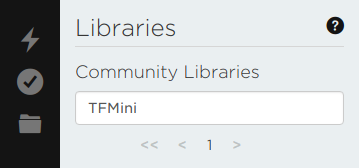

When using the WebIDE, I search for the TFMini library and get no results as shown below.
So if there is a library already uploaded how do I go about using it?
Screenshot%20from%202019-01-23%2011-56-10
The library is private, which is why you can’t see it. But you still can’t upload another library with the same name.
