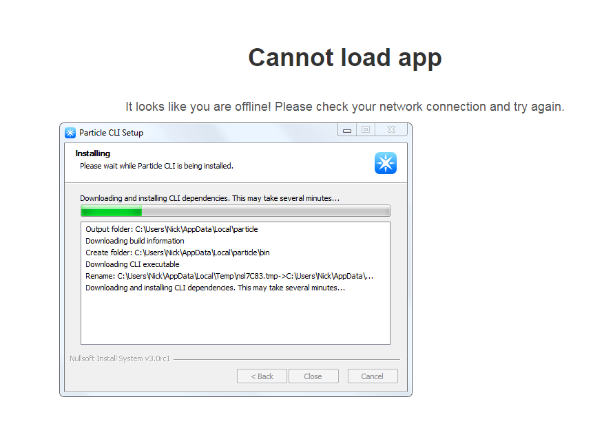

Can you show where it hangs (screenshot)?
Sometimes installing the CLI on a windows machine takes 20+ mins to complete as it downloads and then installs everything. It could take an hour if your internet connection is slow based on my experiences.
Took 1 hour to get to here…
Again I lost connection. 50Mbit download speed from MTN in Cyprus.
Leaving the setup open and resetting router it got to finalize but with errors.1423
