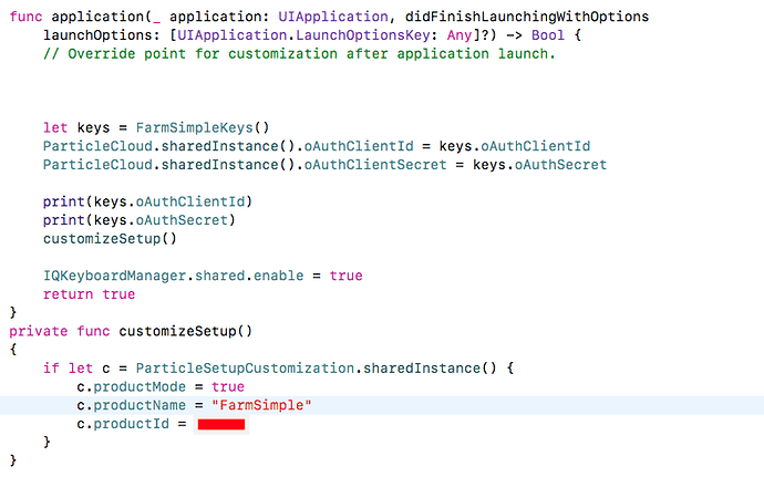

Hello @joost
We already have authentication into AppDelegate file.We tried putting customize setup after token and before token verification.
My product is also not defined as beta into account. Here i am attaching screenshot of our code for your reference.
Can you please suggest. As we still get same error and not able to proceed further.
Rakesh, you did not answer my question why you put “productMode = true” in appDelegate - you do this now by calling customizeSetup() (either before or after setting credentials). There are two seperate processes you need to be aware of:

Naturally, before your app can do anything with the particle cloud, you need to have credentials and your device setup to do this. So before your call any functions from part b. above, you need to finish part a. first. Makes sense? From your info it seems you have not gone through the setup process whereby the device is connected to your network, connected to the particle cloud and your app can reach your device. The “customizeSetup()” function is part of the (a) process, not the (b) process. (btw, I am assuming you are using the simple auth process)
In your AppDelegate() get and set your keys as you do now but remove customizeSetup(). Decide which of your viewControllers is going to be displayed first. Now you need to create some logic that determines if your device/app have been setup before or not - this could be a flag that gets set after your made a succesful connection or you can determine if you have authenticated the particle device (look in the SDK for the call) etc. For now, I’d say just hard code something in your viewWillAppear() call so you are not stunned by artifacts of this process. In viewWillAppear() we will just start the device onboarding process with calls to the particle setup sdk
