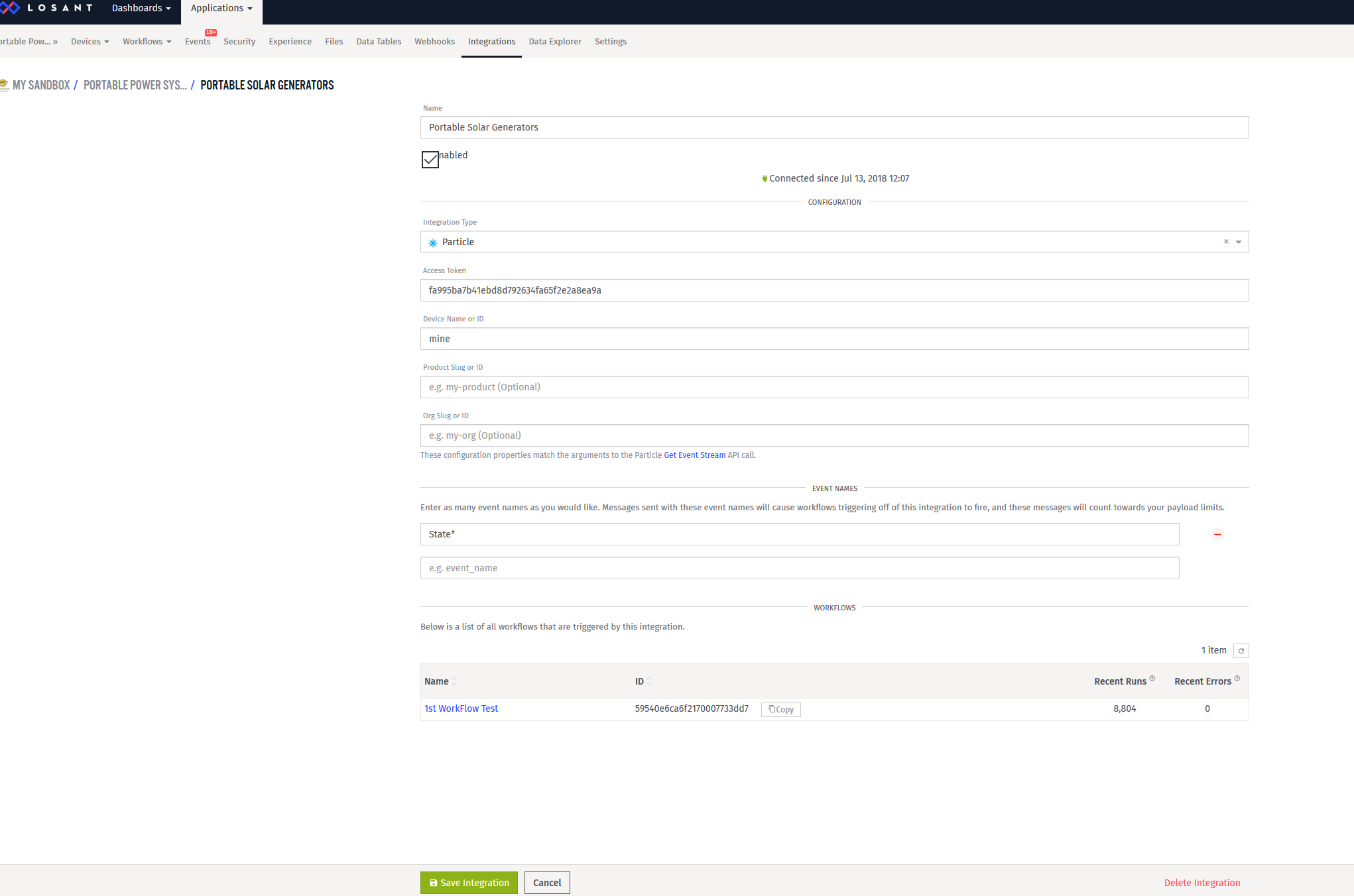

Here is how I have my setup working.
First the Particle Integration:

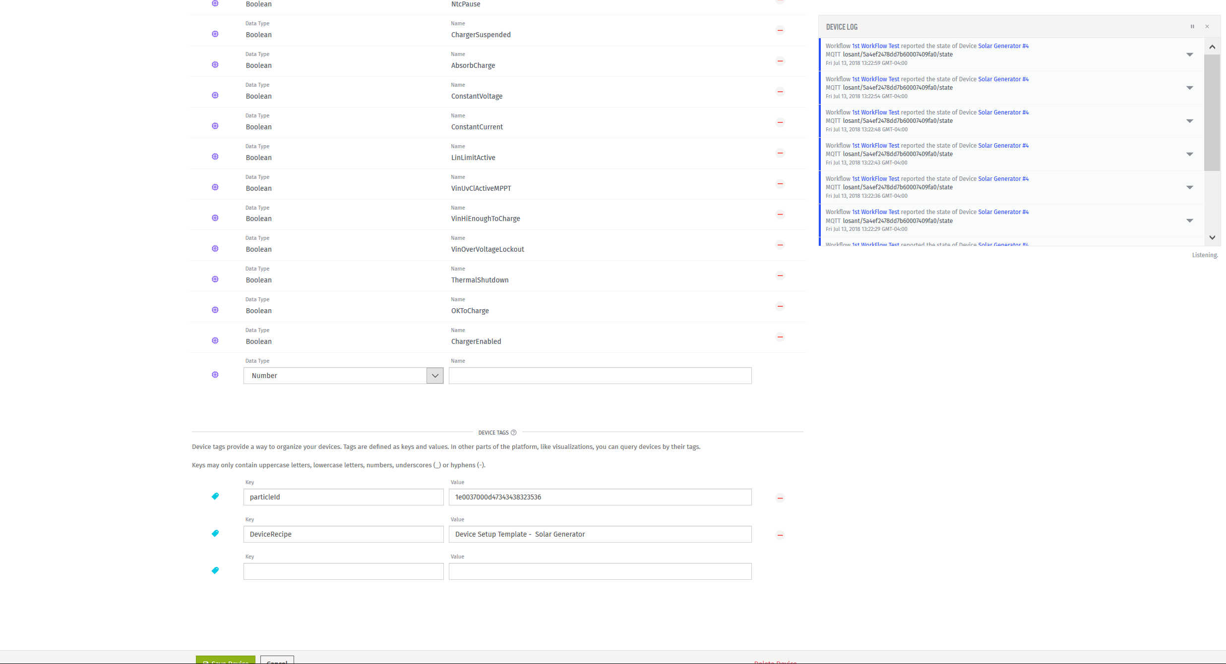

Next is the individual device setup page:

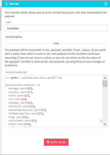

And then the workflow settings that separates the incoming webhook data into individual variables that match the variable names you entered on the device setup page where you named each variable and it’s data type either a number, boolean or string.
I have this setup so the variables are separated by a semi-colon : which makes it really easy to separate variables in the Particle Publish event you send out that Losant receives and then breaks down in the function shown below:

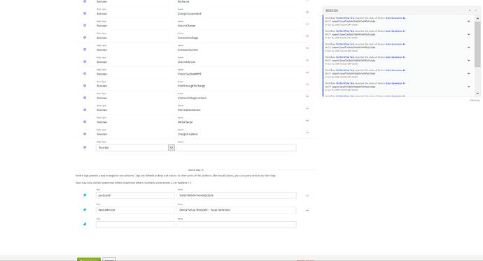

Next is the device state node that saves the new incoming data as a new variable:
Once this is setup correctly you should be able to see the incoming data in the Device Log window at the right of the screen where it says received payload.

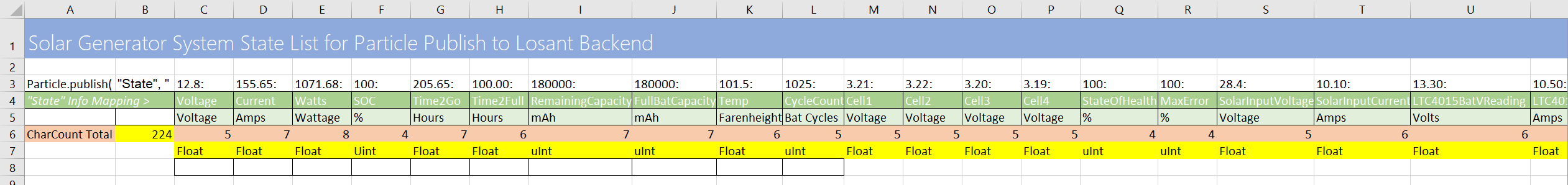

I actually created a spreadsheet to keep track of it all which helped.
I was surprised how much data I was able to pack into a single Publish Event using the semi-colon spacing as the separator.

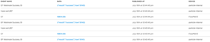

Something is not right… or I did something wrong.
The data is showing correctly on my OLED Screen but the data being published is the second value in the MAP.

Now I tried it with both %.1f and %.2f just to make sure it was not a conflict in data format but I am only publishing the 10614 value, not the mapped value or even the correct value, regardless of flow. Like I said it shows correctly on my OLED just not in the console.
What the heck did I do wrong here?
I think it has to do with you declaring the F variable a String for the OLED display.
Replace the new publish code with this and see what happens:
snprintf(publishStateString, sizeof(publishStateString), "%.2f:",flow );
Particle.publish("EF", publishStateString, 60, PRIVATE, NO_ACK);
yup that was it.

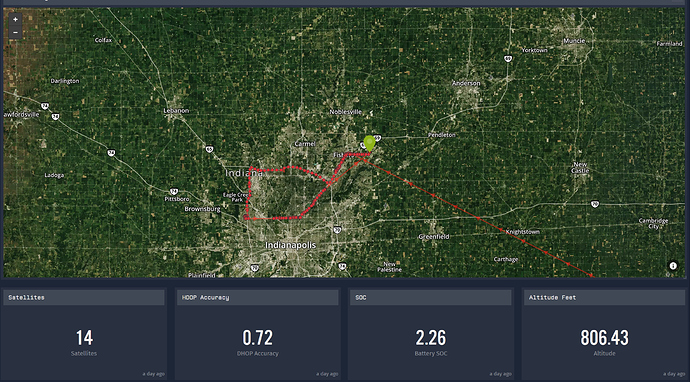

Screenshot just for fun.
