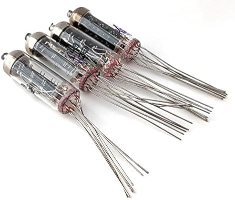

Where did you pick up those tubes? They look nice and clean and I’m looking for the same quality if I can find them.

Just got them from Amazon. I was too impatient for eBay at that time.

Thanks for saving me the time of searching for a good set of tubes.
