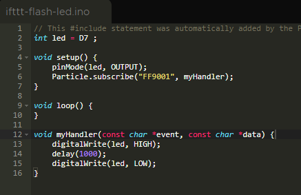

Hi,
I’m a NUB and just wanted to try an IFTTT event with my new Photon. I simple want to flash the on board led when a button widget is clicked on my phone. What am I doing wrong, this seems like it should be so simple? But it does not work for me. Can anyone give me some guidance with this please?
That worked! Thank you for the help, I knew it must have been something simple. But I’m not sure that I understand why that worked. Is it because there is a chance that someone else has a “FF9001” event and they are controlling that event with that name? Because I would think that adding “MY_DEVICES” would be more restrictive and should really make no difference.
