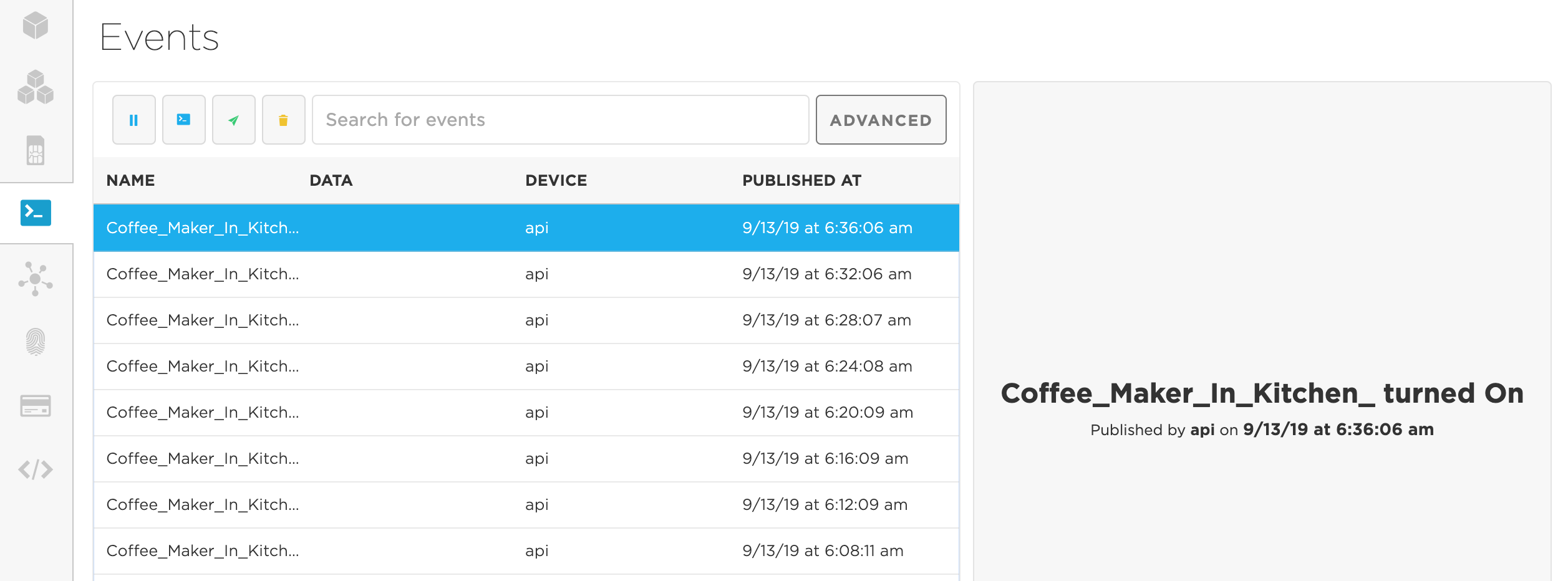

The code below is not activating the relays. The Photon is on a relay shield and I’ve had other sketches work on this same device. So, I’m confident that it’s not related to hardware.
I am using Sense/IFTTT. I do see the event in console.particle.

First, I’d go for a much shorter event name (without blanks).
Next I’d try ALL_DEVICES (for testing only) and/or double-check whether the IFTTT event is actually sent as PRIVATE.

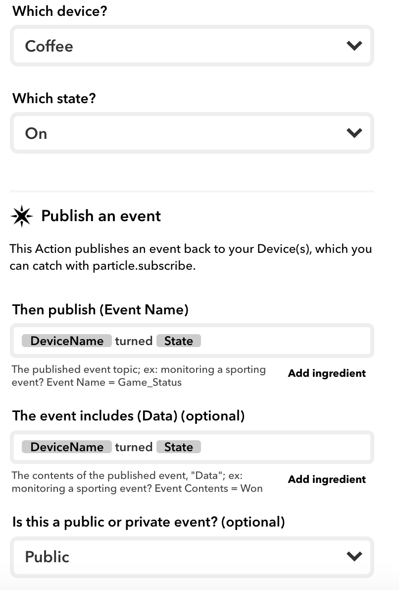

Here is the IFTTT applet
You can try to subscribe to just “Coffee” (anything starting with that should be caught) and also use the console to emit a test event.
Awesome! Thanks.
That worked.
I thought I would have to use the whole phrase. Using just “coffee” was the key.

Even though I seem to get the info from IFTTT ok, I started getting the following on the console as well.
These extra events are normal and caused be the device OS telling the cloud from time to time what the status of the device is.

This would suggest and issue with your IFTTT recipe and/or your circuitry. AFAICT the shown code itself doesn't warrant that behaviour unless a respective event is coming from somewhere.
You should try to correlate the observed behaviour with incoming events - the screenshot you show above does not allow for that.
