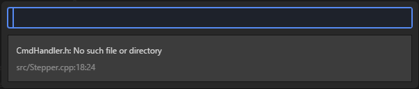

When I compile in Particle Dev, I get

**src/Stepper.cpp:18:24: fatal error: CmdHandler.h: No such file or directory**
 #include "CmdHandler.h"
**compilation terminated.**
But “CmdHandler.h” was included in the list of files sent to the compiler, and this directory structure was working before. Any guidance?
