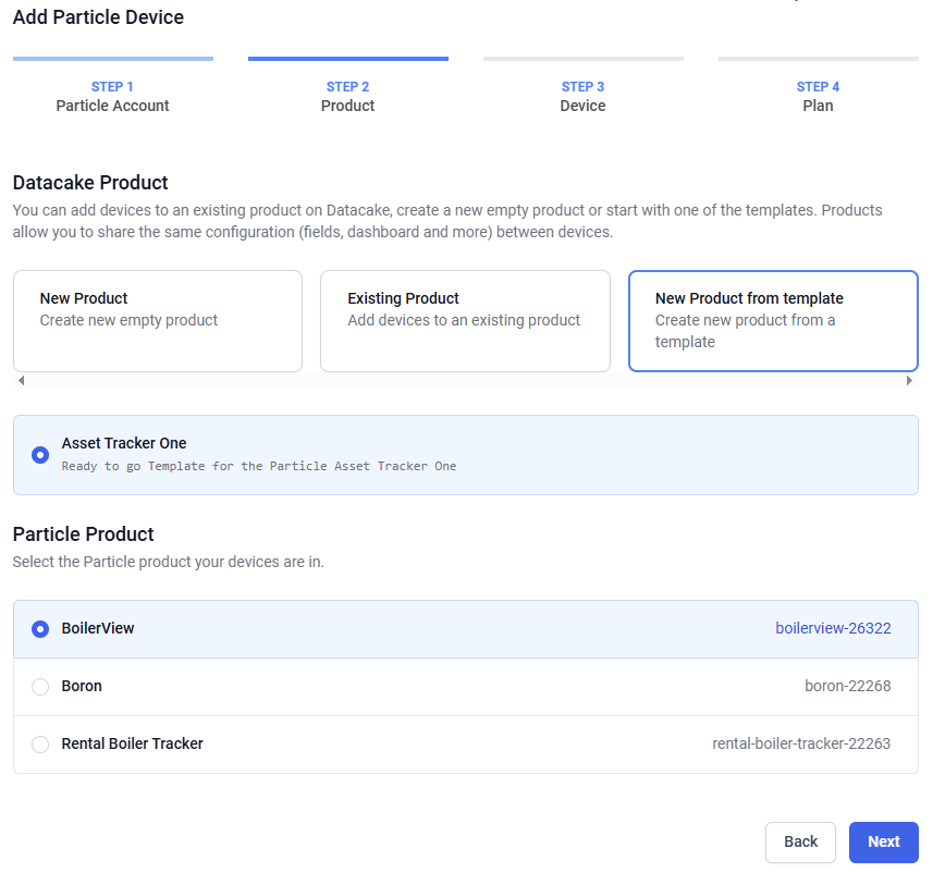

I have the Monitor One correctly configured on the Particle Console (and it is currently reading and publishing Modbus data from a Honeywell RM7800 flame safeguard device). The events are being seen on the console with the correct data and I did have some webhooks setup. When I go to setup the device in Datacake, I see my Particle Products in Step 2:

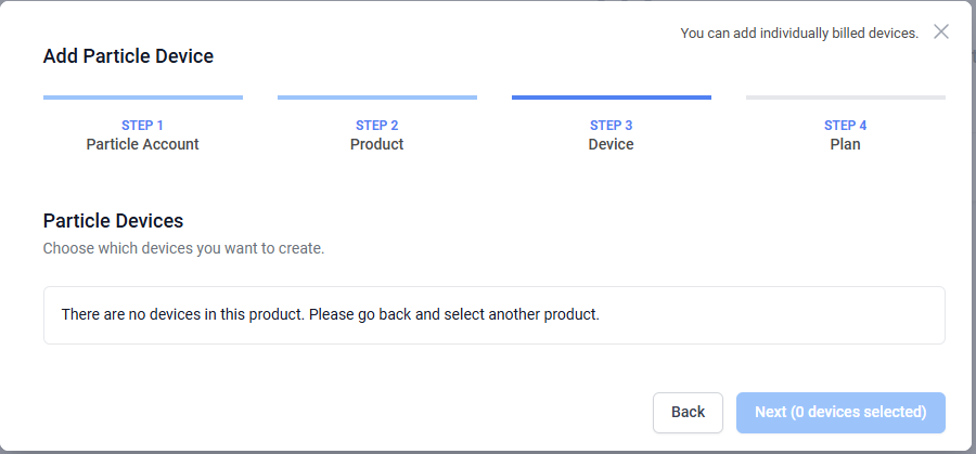

But when I select any of the products (specifically the Monitor One is in the "BoilerView" product), I get no devices:

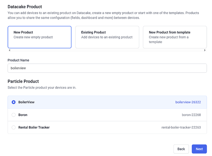

Can you try creating a new product, instead of the template as these steps outline?

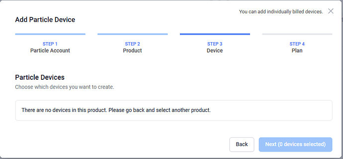

Yes sir, I know my screenshot showed the selected Template, but I have tried creating a new product as well:
I have several other prototype boards/devices in the other Particle Products shown, and none of those show up either.

It looks to be an error on Datacake's side. I pulled up the network request Datacake is making to Particle and it's returning an error when parsing the response. It does seem to recognize your product, however.
    "errors": [
            "message": "Expected Iterable, but did not find one for field 'ParticleCloudDeviceType.variables'.",
            "locations": [
                    "line": 23,
                    "column": 3
            "path": [
                "workspace",
                "particleAccount",
                "devicesInProduct",
                0,
                "variables"
    "data": {
        "workspace": {
            "id": "...",
            "particleAccount": {
                "id": "...",
                "devicesInProduct": [
                        "id": "...",
                        "name": "...",
                        "lastHeard": "2025-06-17T20:33:09.656000+00:00",
                        "lastHandshakeAt": "2025-06-15T13:31:41.929000+00:00",
                        "online": true,
                        "functions": [],
                        "variables": null,
                        "serialNumber": "...",
                        "systemFirmwareVersion": "6.2.1",
                        "groups": [],
                        "canBeAdded": true,
                        "__typename": "ParticleCloudDeviceType"
                "__typename": "ParticleAccountType"
            "__typename": "WorkspaceType"
I will open a ticket with Datacake outlining the problem.
If you want a quick patch, I would suggest trying to add a Variable to your device to see if Datacake is able to parse your device correctly.
I added a dummy variable just to test and I see it on my Console but still no luck with datacake. Thanks for submitting the ticket with them!
