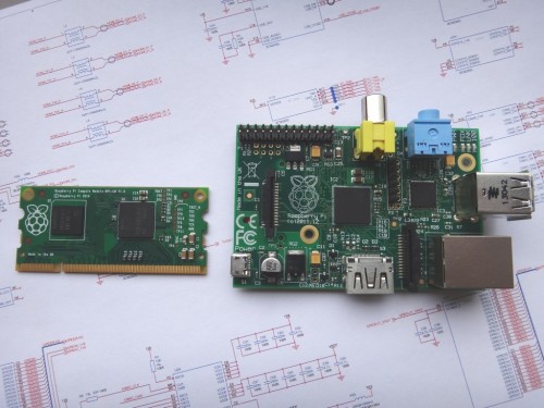

This just came out minutes ago!
I can’t imagine running my API server on these cool little blades in future :smiley:
Interested parties, let’s work together and design a main board which can connect a couple of these blade computing modules up!!!
