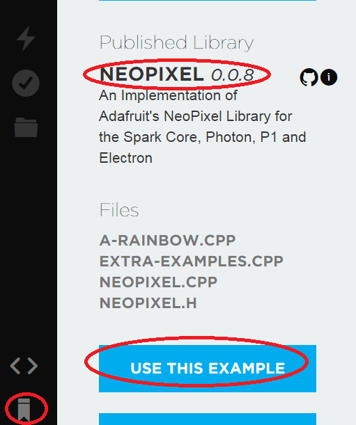

Here is what I am finding strange. When a user clicks the library “Use this Example” button, the particle IDE makes a working example. That is great, really really great.
However, if I then copy that code and make my own .ino with that code, it does not compile.
The IDE is doing some linking of files in the background. Can I do the linking manually?
CLICK - USE THIS EXAMPLE
COMPILES, WORKS GREAT
COPY THE APP, DOES NOT COMPILE
Any idea how I can get my own apps using the internal includes such as
#include "neopixel/neopixel.h"
I can see that the NeoPixel is included in the A-Rainbow.ino, but I do not know how to include it in my own app.
Give the “include in app” a try?
https://docs.particle.io/guide/getting-started/build/photon/#using-libraries
