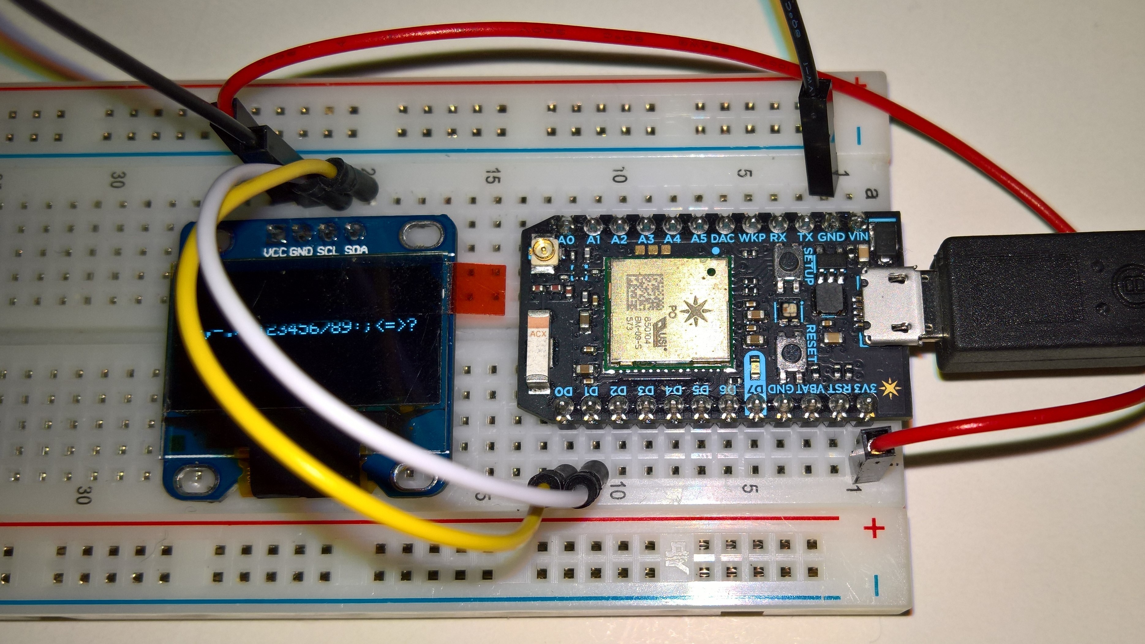

Can't get SSD1306 example to compile [SOLVED]
I start with a Google search and find this post on how to use an example from the Wed IDE Library

I continued past this stage trying all sorts of things but with no luck.
I must be doing something wrong. However, I do feel the "Use this Example" should be a better experience. Also if the example I selected does in fact NOT work on any of the particle platforms. Why is it in the library?
Anyway, I'd appreciate any help on getting the SSD1306 OLED working on the Photon.
Thank you.

Hey @ScruffR, thank you for your quick response to my post. Folks can almost always count on your prompt help!.
Since my post I “manually” created an app by added new files and copy pasting code from the Adafruit_SSD1306.h/.cpp and Adafruit_GFX.h/.cpp library files into these files in my project/app.
My .ino file was almost exactly the same as the Arduino code from Adafruit’s example program for the I2C version. The only change I made to this file was the binary numbers, where I prefixed with zeros as follows:
static const unsigned char PROGMEM logo16_glcd_bmp[] =
{ 0B00000000, 0B11000000,
  0B00000001, 0B11000000,
  0B00000011, 0B11100000,
  0B11110011, 0B11100000,
  0B11111110, 0B11111000,
  0B01111110, 0B11111111,
  0B00110011, 0B10011111,
  0B00011111, 0B11111100,
  0B00001101, 0B01110000,
  0B00011011, 0B10100000,
  0B00111111, 0B11100000,
  0B00111111, 0B11110000,
  0B01111100, 0B11110000,
  0B01110000, 0B01110000,
  0B00000000, 0B00110000 };
The code compiled and the app works!
The Pin connections between the 128x64 0.96" display and the Photon are as follows
Wiring Instructions
SDA pin of Display goes to D0 pin on Photon
SCL pin of Display goes to D1 pin on Photon
GND Pin of Display goes to Gnd pin on Photon
VCC Pin of Display goes to 3v3 pin on Photon
The I2C address on my Display is 0x3C so display.begin() line in the setup method looks like this:
// by default, we'll generate the high voltage from the 3.3v line internally! (neat!)
  display.begin(SSD1306_SWITCHCAPVCC, 0x3C);  // initialize with the I2C addr 0x3D (for the 128x64)
  // init done
Thank you once again.
Here is a Photo of the Photon and Display
Here is a snapshot of the Project in the Wed IDE
