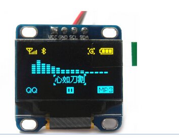

I see, your breakout looks different to mine. I’ve actually got a combined SPI/I2C board for which the original address works.
That shows once more that SSD1306 is not SSD1306 :wink:
However, good to know you got yours working :+1:
For the record…
You need 4.7k pull up resistors on SDA and SCL. I have the same display and posted my wiring in one of the many OLED display threads. I’m sure there is a way to find my posts and find it.
Thank you Luke for your reply. Can you explain why I would need them?
If it is working (hard to tell from your last post) then leave it be but I have that same display and it didn’t work without pullup resistors. I don’t exactly know the electrical “why” but received that suggestion when I was trying to get mine to work and that fixed it for me.
Sorry yes it is working without the resistors.
