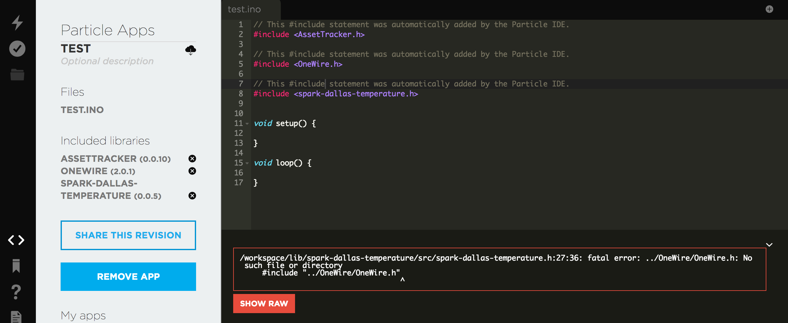

I’m trying to include AssetTracker.h into my existing project (again) after it appears to have disappeared completely from the project itself.
Steps followed:
  1. Search for official library ‘AssetTracker’
  2. Click include in project
  3. Step through and click include
  4. Try to compile project, get the error that the .h file is missing
Please see screenshot
Is anyone else having this issue? Would really appreciate any guidance - it is preventing us from doing new builds.

Strange, I just removed Spark-Dallas-Temperature by tricking Chrome into finally letting me click the remove button (left click, hold, right click hold, release buttons, wait for pop-up seemed to work).
That didn’t fix it, but what did fix it was:
  1. Create a new project file
  2. Add in the libraries
  3. Copy and past all code (exact same code)
  4. Compile
  5. Working
Unsure what is going on, I’m suspecting the upgrade from the ‘old project file format’ to the new one when libraries changed didn’t kick in correctly?
I am still having issues with OneWire reference in dallas-temp due to that folder in a folder reference, about to try fix that by manually copying the library in and adjusting that line (hopefully works…)
Thank you @kennethlimcp for helping to show it was working in another file - that gave me the idea to create a brand new project and try it again, which worked! While I avoided the problem and didn’t really ‘solve’ it - it at least helped me continue on.
I also got the dallas temp library working which was good
Step 1. Remove OneWire & Dallas Temp libraries from left hand menu
Step 2. Add in files for the libraries manually at the top of the code screen (.cpp and .h files for both libraries) - see screenshot
Step 3. Copy and paste the library code into the files
Step 4. Edit the dallas temp file - circled in red in the attached screenshot.
The library pointing/referencing wasn’t playing nice, even removing the …/OneWire/OneWire.h and making it OneWire.h or …/OneWire.h didn’t work for me… meh :expressionless:
Hopefully this helps someone else :slight_smile:
