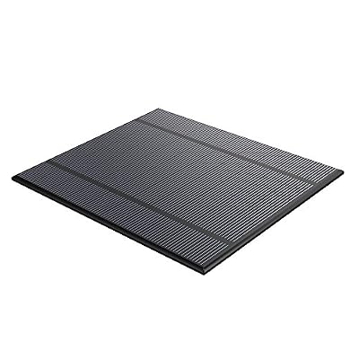

I did! I was able to reduce my power consumption by about %30 by switching to GPIO control instead of running off 3v3 :smile: One thing I had to do was at the end of my code, I changed all GPIO pins to Output and set them LOW. It seems like system.sleep lets a pin float a bit if it is left as in Input. Now I am losing 0.3% SoC every three updates instead of every update (my updates are every 20 in so this is huge). I am using the LiPo battery that comes in the Electron kit and two of these:
They charge up very well and very fast. The reason power management became such an issue is we are trying to operate during Seattle fall/winter conditions :stuck_out_tongue:
