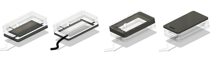

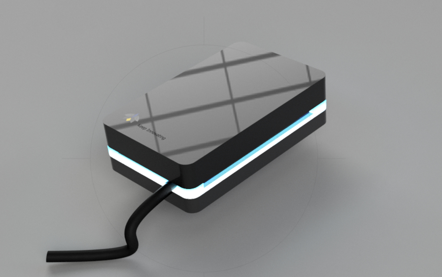

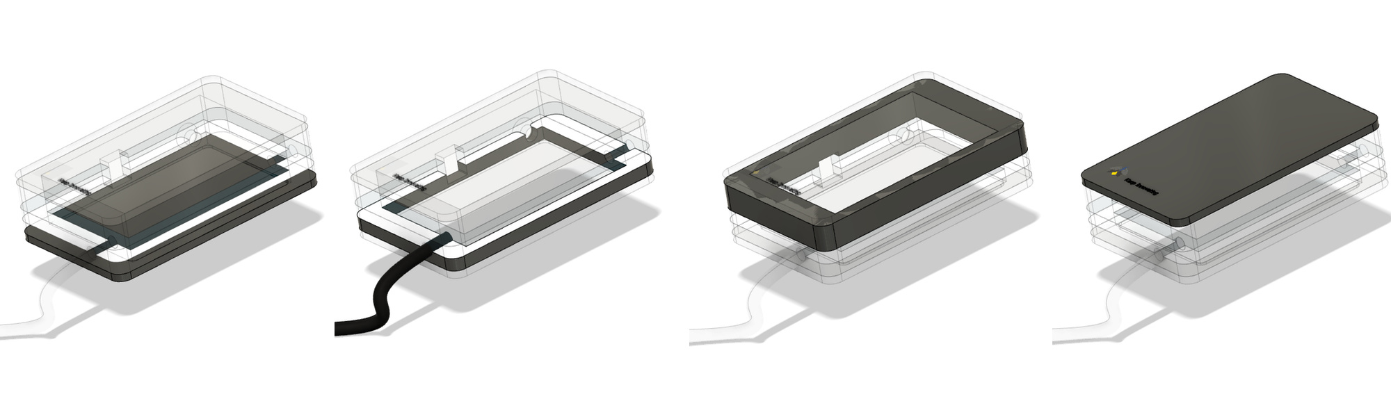

Step 1 - Enclosure design:
Designed a simple and safe enclosure to accommodate the custom PCB using Autodesk Fusion360. If you are more familiar with Autodesk Fusion360, I can highly recommend the following set go instructional videos by Lars Christensen. You will be designing simply enclosures in no time!

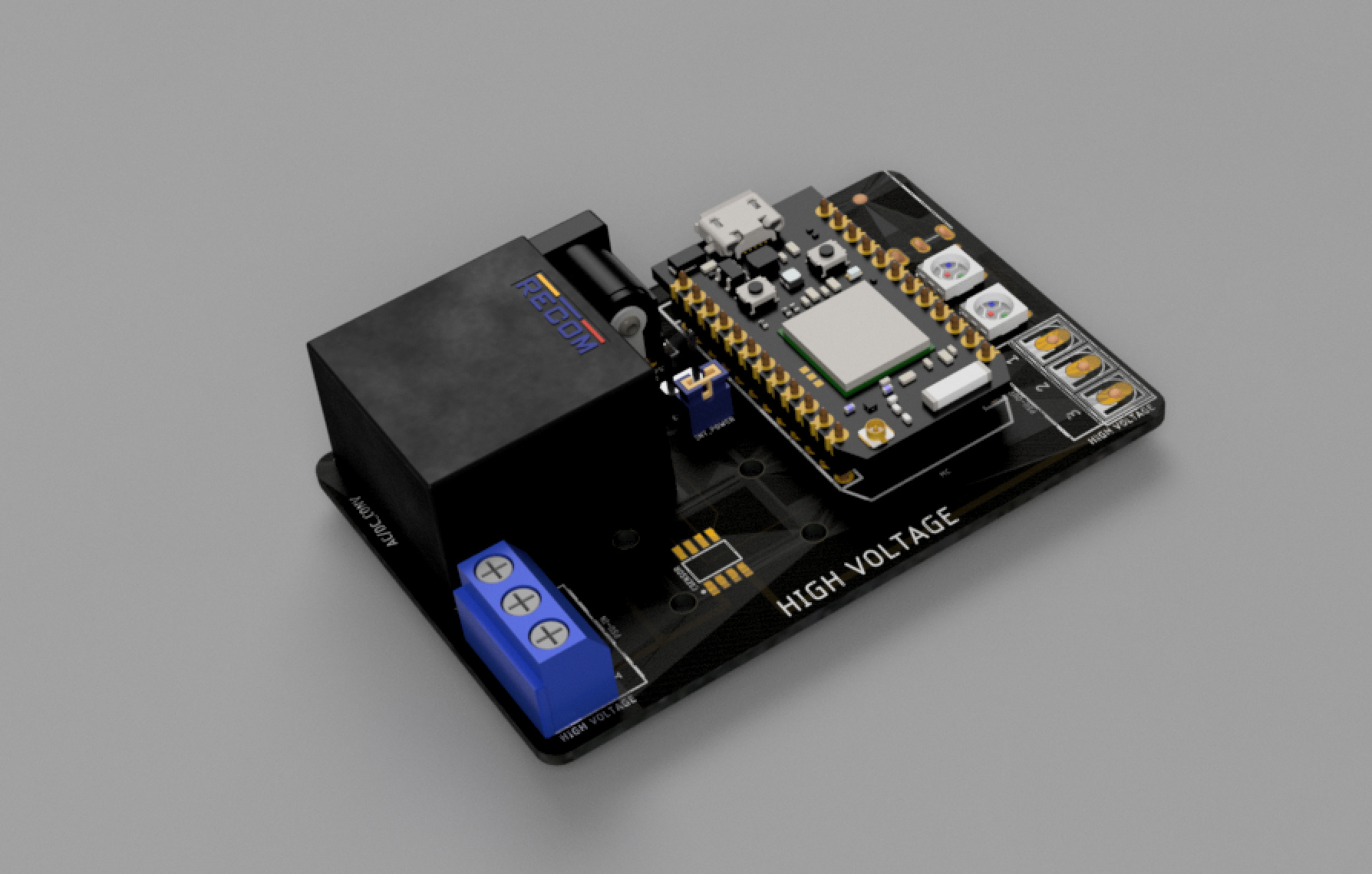

Step 2 - Custom PCB (Autodesk Eagle)
I managed to repurpose a previous PCB design due to the simplistic nature of this device. The PCB accommodate an AC/DC converter, Particle Photon, some resistors and capacitors, and finally some 5050 RGB LED acting as Status LED’s mirroring the Particle onboard LED. I suppose the device can be smaller (70mm x 50mm currently) but I had some PCB’s left over from another project, so I thought why not. I removed the components I was not going to use from the render.
Thanks to the RECOM RAC05 AD/DC converter, the design allows for the use of either high voltage (110V - 240V) to power the device OR 3.3V - 5V external power supply by simply setting the onboard jumper accordingly.

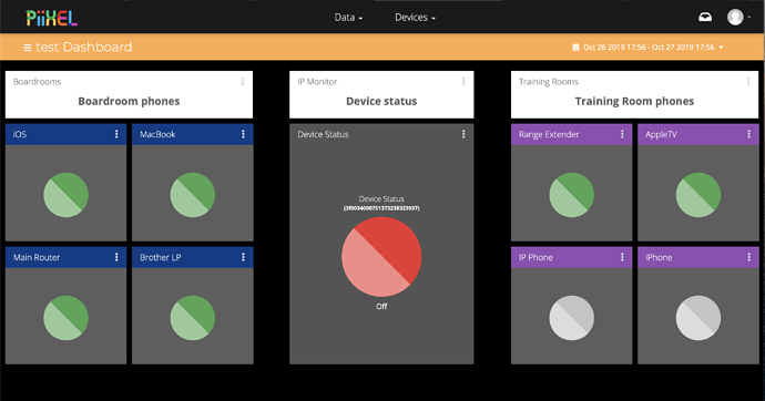

Step 4 - Ubidots Dashboard
Below is an example of a dashboard that can be done in Ubidots in just a couple of minutes without any programming knowledge. The dashboard example shows the 8 devices (IP’s) that are constantly being monitored for connectivity. It also indicates the actual device status. With a little more effort, the individual IP’s can also be rendered a different color when the main device is powered off, by setting up a couple more events and variables in Ubidots.
Further to displaying the information on the dashboard, notifications can also be set up to alert dedicated email addresses or send text to phone numbers in the event of phones being disconnected for prolonged periods of time.
