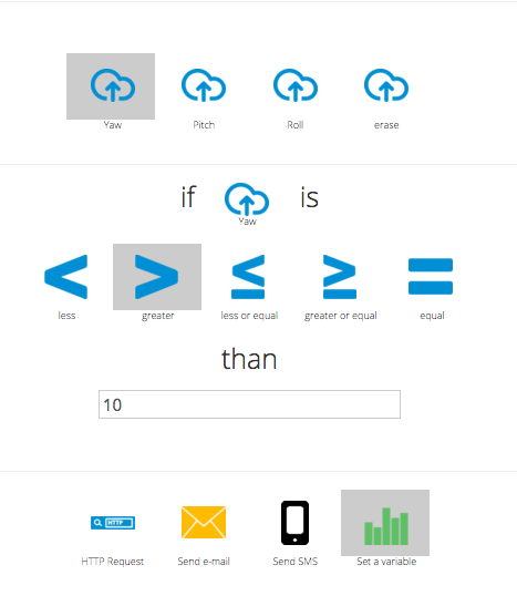

Sure @1eb13, let’s assume this scenario:
  1. Photon #1 measures light, sends it to a Ubidots variable called "Light"
  2. Photon #2 controls an LED, reads a Ubidots variable called "LED"
In this case you need to create two events in your Ubidots account; one to turn the LED on, another one to turn it off:
  • IF light > xxx THEN “Set a variable” --> Select the LED variable --> Set variable to: 1
  • IF light >= xxx THEN “Set a variable” --> Select the LED variable --> Set variable to: 0
Example:
…choose variable…
Thanks for your suggestion. I didn’t realize that Ubidots could do all that!
