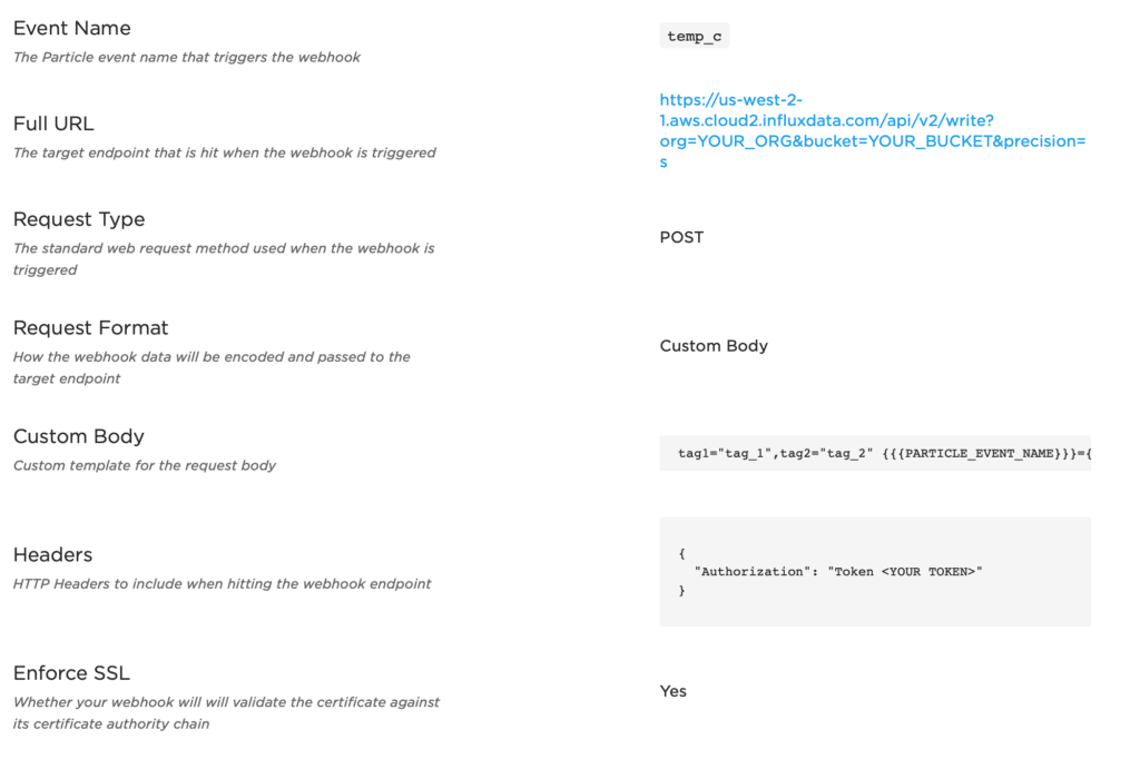

Has anyone had any success getting this working:
I am constantly getting error 401 so an issue authorizing. I think I have followed the instructions correctly but obviously something is wrong.
