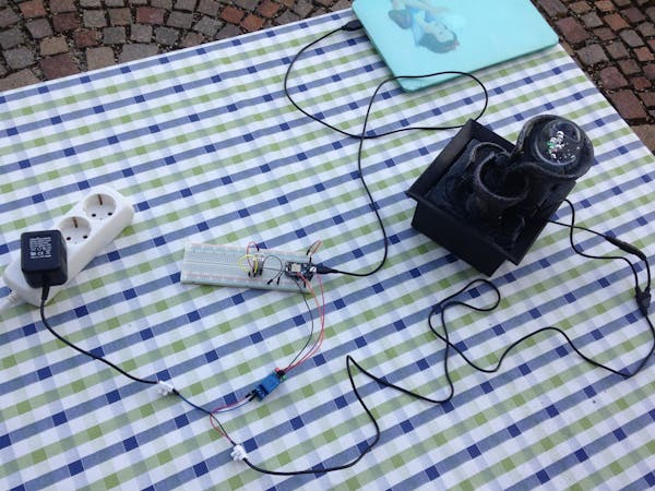

Here an example with a relay to cover the 12v circuit:
