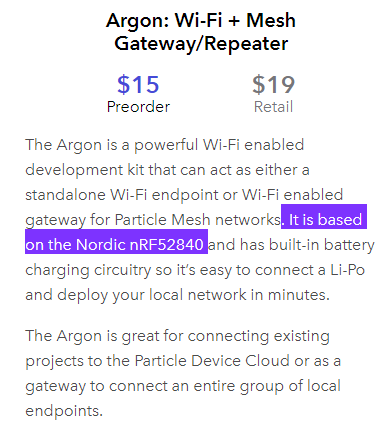

I don’t keep track of all official or inofficial statements about the Argon, so I don’t know where this “powered by the ESP32” statement stems from, but when it’s worded like this somewhere that’d explain the confusion.
And that’s why I wanted to point out the probable misconception.
The official product description I know from https://particle.io/mesh reads
Also, the ESP32-S0WD is a single-core variant of the ESP32.
So, ruling out the ESP32 since the Particle Mesh devices are powered by the Nordic nRF52840, it seems we might actually be in a better place.

It actually says “powered by the ESP32” on https://www.particle.io/mesh/
Is this incorrect then? Or does the Nordic chip just provide the BLE part of the device?
TT
Again, the Nordic chip is the main controller for all mesh devices, the ESP32 only “powers” the WiFi connection.
The term “powered by” might give rise to that misinterpretation, but since it’s not a very technical and unambigous term I’d not overinterpret it’s meaning in that respect.
You can also see it used in other connections in the same screenshot.
You would also be correct in saying the device can be “powered by a LiPo” battery.
